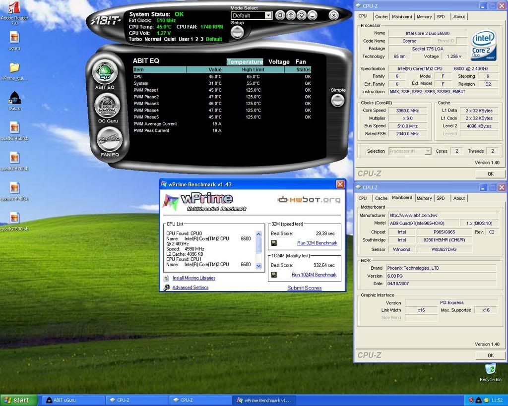

Not sure for the moment but at least 30' OCCT. So it seems to be :)
All benchs @3900@1.58 but OCCT impossible cause PWM temp raise above 130° :(
Need a mobo with RockSolid VRM!
I'd love a new ABIT, but IX38-QuadGT will have same Numeric VRM :(

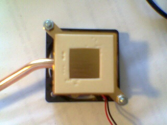

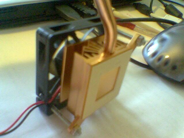

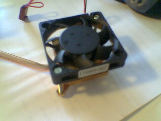

yay nice going there aster :up: You should remove the mosfet cooler and remove that tim strip as well. Apply some thermal grease and put it back. Also let a fan blow on your chipset (cause if the chipset gets very hot, the heat goes to the pwm's because of the heatpipe). I did a little mod today:
http://i172.photobucket.com/albums/w...Mod/Afb028.jpg
http://i172.photobucket.com/albums/w...Mod/Afb029.jpg
http://i172.photobucket.com/albums/w...Mod/Afb030.jpg
http://i172.photobucket.com/albums/w...Mod/Afb031.jpg
This is a 50mm fan :)
Sorry for low-quality pics (blame nokia, not me :p)
Greets,
Techie

It's a 50mm fan and it really works veeeeery well! :D btw for all the people who want to change to a P35 board for there quadcore cpu:

You can mod the thermalright hr-09 for this board. But there are other ways to do it :p
http://i172.photobucket.com/albums/w...Mod/Afb037.jpg
My screws are too short (I'm going to get longer one this afternoon), but here is a proof that a 50mm fan fits perfectly:
http://i172.photobucket.com/albums/w...Mod/Afb038.jpg
Greetz,
Techie

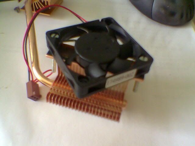

hmm yes the tuniq tower is one fat :banana::banana::banana::banana::banana: lol :p i use vapo on cpu so space ain't a problem :p just bought 3 brand new 50x50x10mm fans (Papst F 512/2) and some longer screws:
2 x 3,5cm screws for northbridge
2 x 2,5cm screws for southbridge
2 x 5cm screws for mosfets
These are the perfect screw sizes :p

I used bios version 13 and had now problems lowering the multiplier on my E6600:
http://i172.photobucket.com/albums/w...GT510fsb-1.jpg
But ofcourse you need the bios 14 because of 1333FSB support :rolleyes:

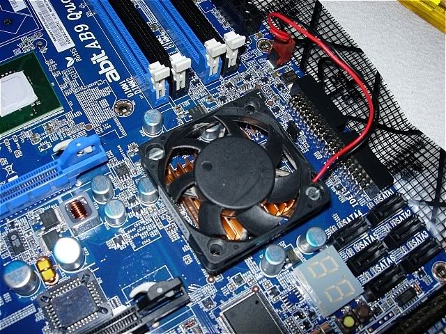

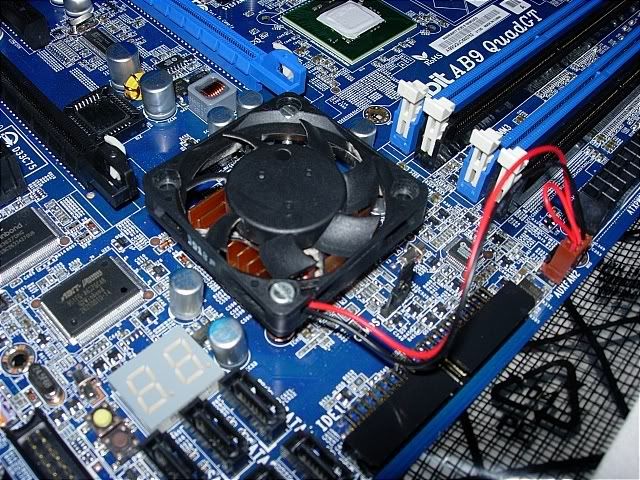

putting a fan on the PWM's seems to keep the nb much cooler as well. Here it is
http://img.photobucket.com/albums/v1...f/IMG_6479.jpg
http://img.photobucket.com/albums/v1...f/IMG_6478.jpg

One tip while running a quadcore: Use an aftermarket NB heatsink. The PWM gets too hot if you keep the stock sink attached to the NB. I have my NB watercooled and the stock heatsink bent like this
