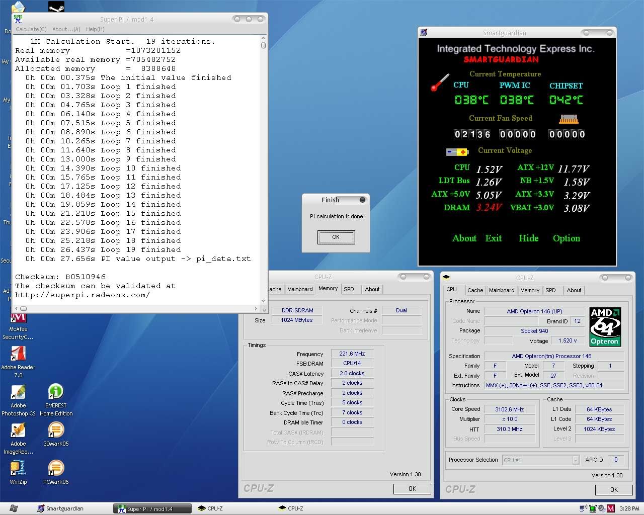

http://i15.photobucket.com/albums/a3...uperPi1M22.jpg
Did up to 3110 with 1.525V before it started to crap out. :)

http://img.photobucket.com/albums/v7...E/94c3bc3a.jpg

Alright this is my 2nd best, the 0154 batch CPU on my stupid air cooling with frigging terrible temps.
http://img.photobucket.com/albums/v7...E/a6fad857.jpg
http://img.photobucket.com/albums/v7...E/5d554aa3.jpg
I don't think too many Opterons can prime at 3.1 with 1.56v and 48c load ;)
