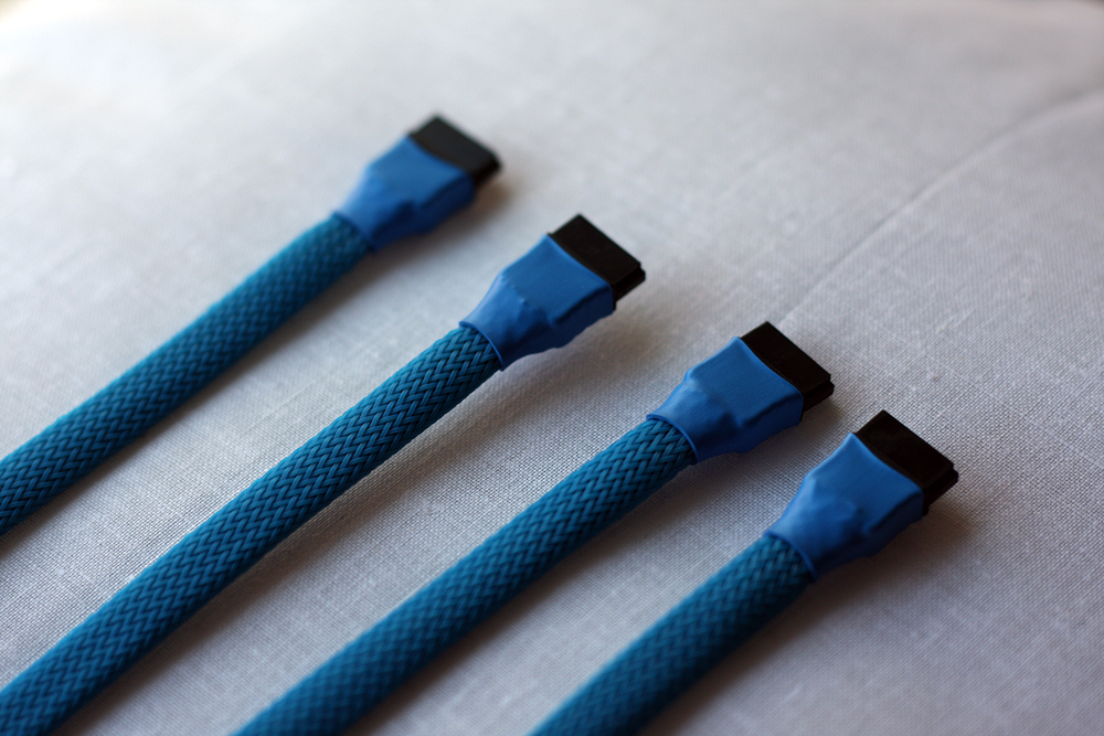

Turned my attention to the S-ata cables, some success at last!
So pleased with the results...
http://www.nickgoodall.co.uk/pics/co...e/IMG_6149.jpg
http://www.nickgoodall.co.uk/pics/co...e/IMG_6146.jpg
http://www.nickgoodall.co.uk/pics/co...e/IMG_6180.jpg
And of course, I see a theme from the above post also hehe ;)
http://www.nickgoodall.co.uk/pics/co...e/IMG_6143.jpg

nice but too much sleeve melting and too long heatshrinks IMO :)
