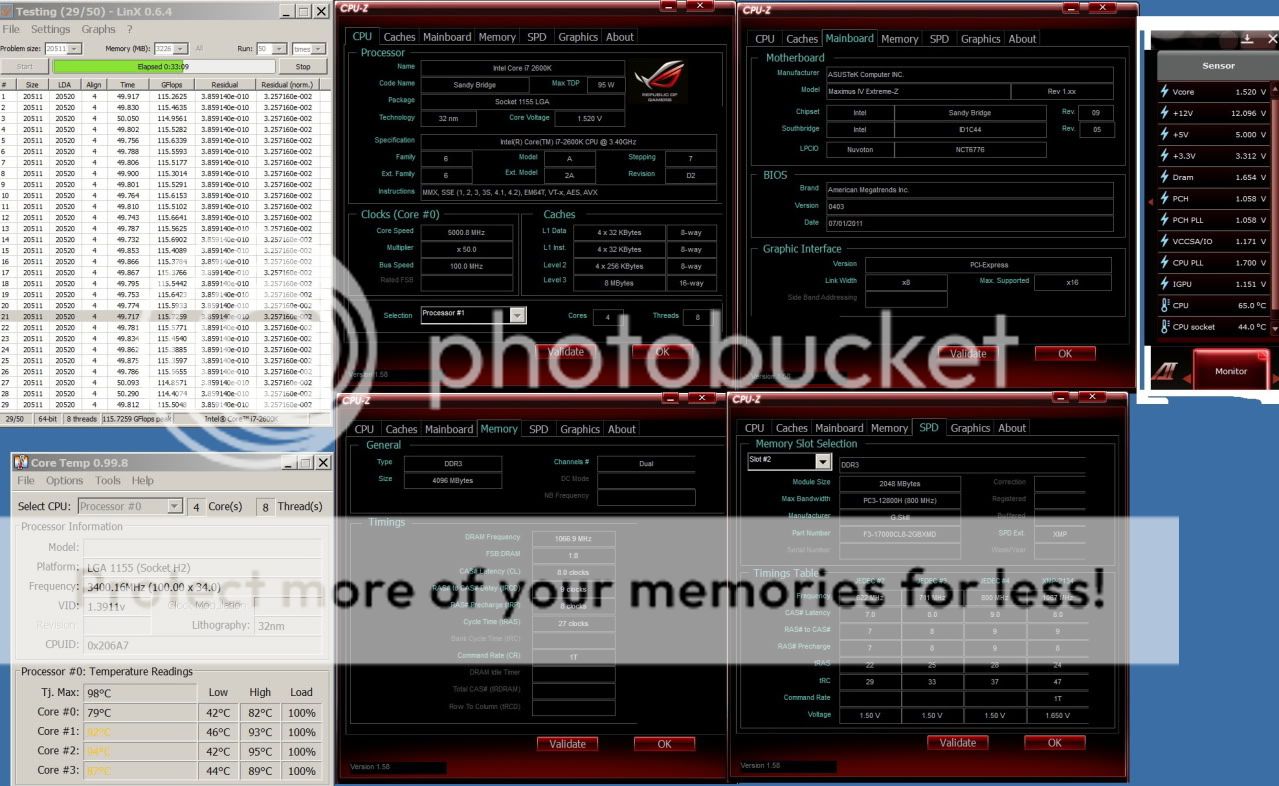

2600K @ 5.0GHz Costa Rica
GSkill RipjawsX 2133 8-9-8 2x2GB
Ambient temp: 34C
http://i458.photobucket.com/albums/q...0153vLLC75.jpg
Still hunting for a better chip:rolleyes:
