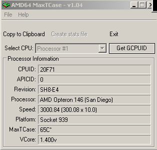

Here is a 65c TCaseMax:Quote:
Originally Posted by _33
http://www.desertshooter.nl/kakaroto.png
Its an Opteron 146, which does 3ghz prime stable, of some guy called kakaroto on a dutch forum.
- Schmetterling
