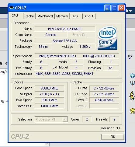

I just got the chip in last nigh. Popped it in and it's currently going at 2.8 (350x8) @ 1.35v. Tried 360 with vcore up to 1.375, but it wasn't happy about that. Also tried 410 x 7 and it wasn't happy with that either. Didn't want to push voltage too much, as at 2.8 and 1.35v it's already at about 63° with the mini typhoon on load.
Should I wait for the AS5 to settle a bit before I try to push it any further?
Here's the stepping info on the cover too. Very interesting!!!:::
Intel Confidential
QJNG ES A4
05 HH80557PH0464M
C601506B
I didn't think to snap a pic before i threw it in there. Would I be correct in assuming that's an engineering sample?

So yours is an ES B1? Mine doesn't even show up as being a Conroe in CPU-z... well, at least not in the specs section:Quote:
Originally Posted by ziddey
Here's mine
Wow A1 was the first of the engineering samples I think. That's strange since the other A1's I've seen all had true unlocked multis from 6-40. Sorry to hear that you got such an early one. How does it work?Quote:
Originally Posted by NINaudio
It's not really an A1, cpu-z just reads as that. On the actual processor die itself it says A4, I unfortunately didn't think to snap a pic before I installed it. I'll probably get to play around wiht it a bit more this weekend, but so far I haven't pushed it more than it says in my sig. Anything much higher than 350 and it would fail orthos in a matter of seconds and if I pushed the voltage much more it would start to load about 65° C.
