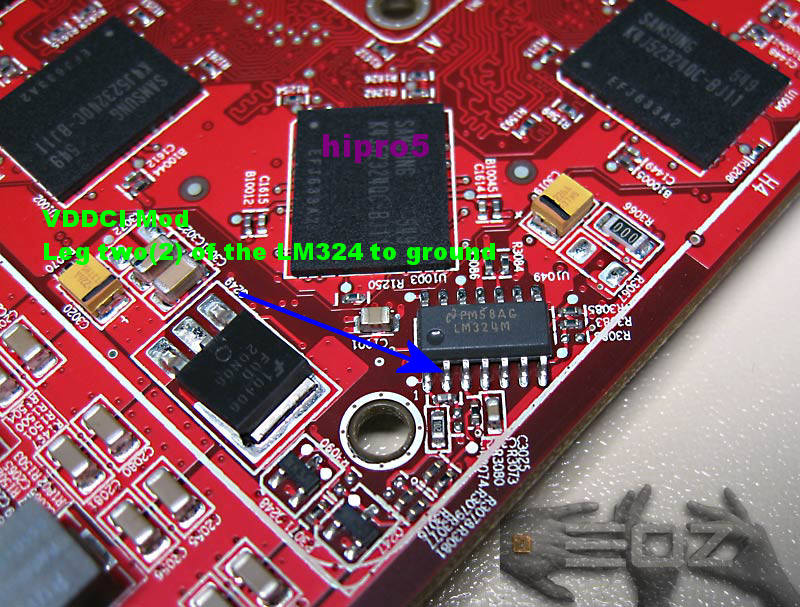

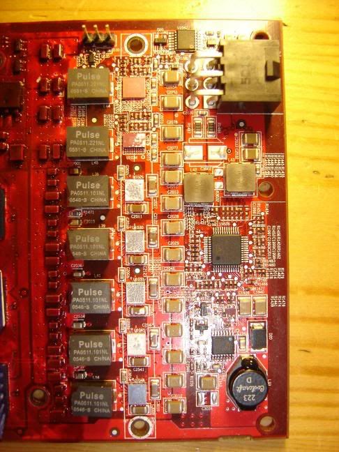

ok guys, here are the 2 pics ;)
http://www.xtremesystems.org/forums/...9&d=1142521570
http://www.xtremesystems.org/forums/...0&d=1142521570
:) :toast: NICE photo...........
http://www.thelab.gr/images/Hipro5/D..._Mod_2_jpg.jpg

Maybe this Hi-res VDDCi pic help's. 8]
BTW, my R1454 SMD restor resistance is ~602 Ohm'z.

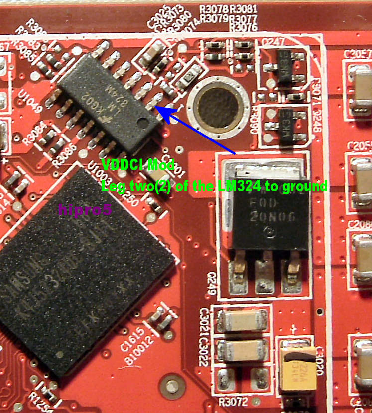

IF someone could post a picture WITHOUT the heatsink of the Mos-Fets (of the VDDCI side), I would be delightfull to do so.....There is no way to take off the heatsink again of this VGA......TOO dangerus......:)
here you go, i hope its a good one. Jort has taken the pic and his going to do the mod too :)
http://i3.photobucket.com/albums/y90...ripper/mod.jpg
here is a bigger one;)
http://www.belgium-coolingsolutions....X/X1900XTX.jpg
There you go.........:)
http://www.thelab.gr/images/Hipro5/D..._1_Mod_jpg.jpg
BE VERY CAREFULL..........VERY delicate components........:)
