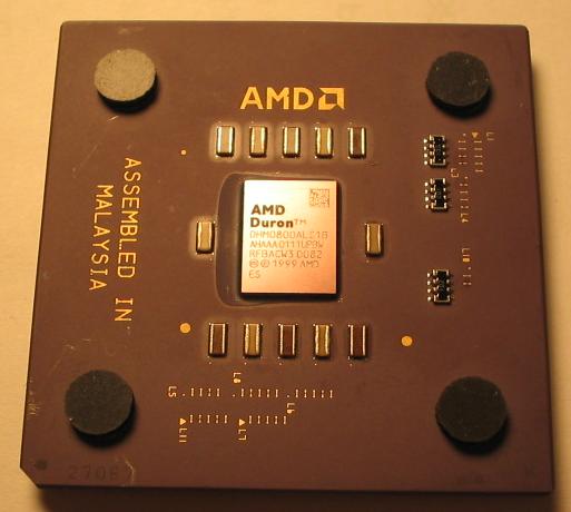

Duron got their 5th letter in the beginning of 2001.
Duron 800
AMCA 0101MPMW
Duron 800
AHAAA 0111LPBW

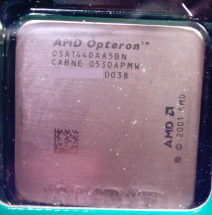

What do you think about this Opty 144 CABNE 0530APMW?
http://img.photobucket.com/albums/v6...t/6292f6d4.jpg
