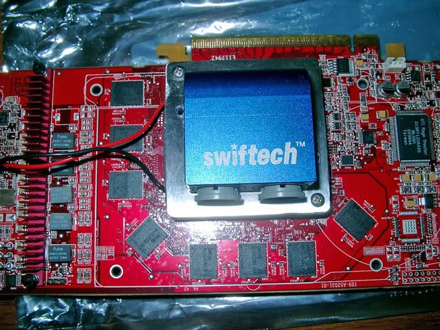

http://img.photobucket.com/albums/v31/canny/Swif-on.jpg
172W pelt, too bad it won't load Windows under -0°. I wonder what thats about.

Cards definately cold bugged somehow. I have to pull the pelt to try another driver. I was able to get into Windows last nite with 80° water on the pelt, and it was very unstable with the card drivers eventually not responding. Anything less than that H2O temp I could not even load Windows.
I wonder if this is something like Fugger was seeing. He said he had to ground the phase block or something.
This was on all three OS partitions :slapass:
