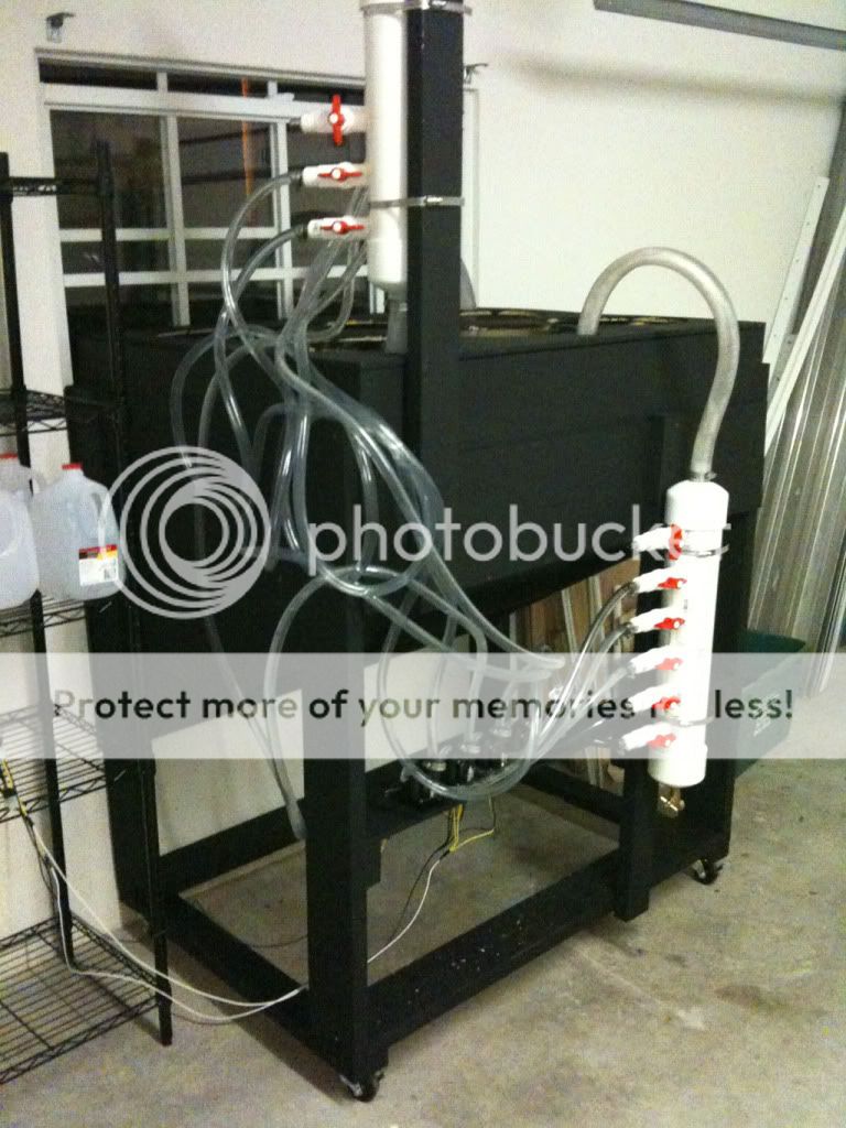

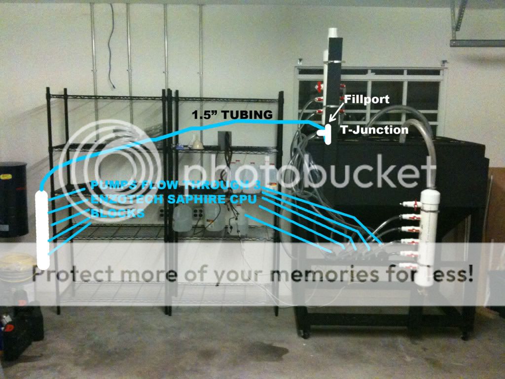

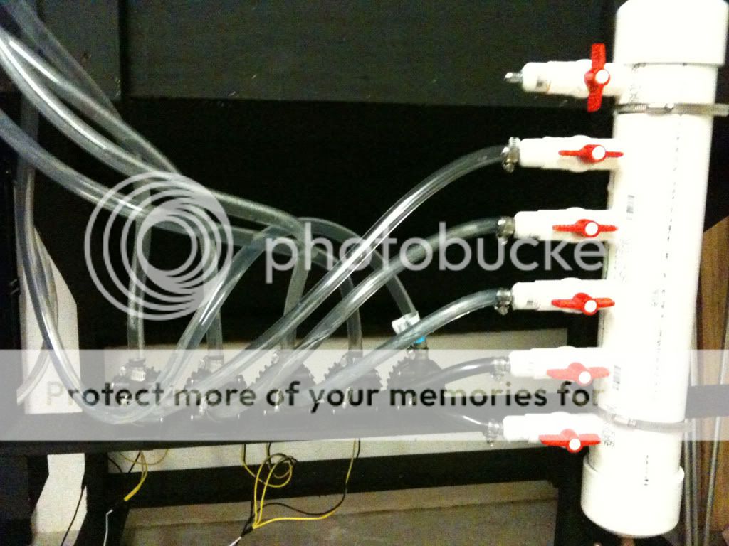

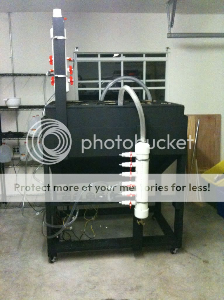

not sure about it, but maybe a few things,
1st, the outtake of the reservoir is quite large isn't it? you can set it maybe a bit smaller to keep pressure with a tighter pipe (maybe 1/4") and some expanding adapter to fit with the screwing.
2nd, these are huge radiators, they can probably take 4 CPU's with ease each and squeezed to 5, it takes some more looping for the fluid to go through so weakening the effect of the pumps.
3rd, the heated water coming out of the blocks should create more pressure then the cooled one's, that's maybe a point to consider.
last thing is the pipes, shorter they are, less is the friction and the distance the pumps need to push the water mass/weight, so it should build up some pressure as well.
you can maybe add a pull pump at the outtake going to the rads.
