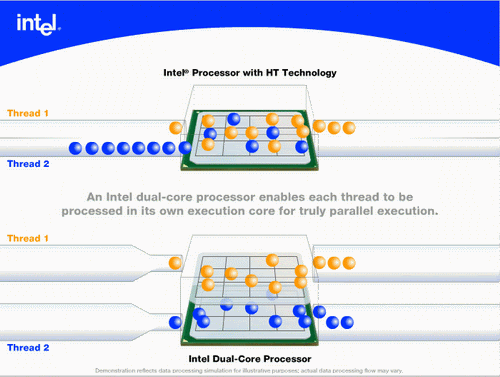

http://i473.photobucket.com/albums/r...anadej/HTT.gif
Straight from Intel and in such a pretty diagram that most people understand right away....

So what should we understand ? That instructions from 2 different threads are in flight at the same time in various execution stages ?
Sounds awfully familiar with what I'm saying : SMT means the simultaneous execution of 2 threads or more in parallel.
Maybe, you should answer why it's called simultaneous in the first place.
What's your point, somehow I am missing it ? What do execution units have to do with executing threads simultaneously ?

You don't appear to understand what is really going on yourself. There is only one execution unit. You can't have two threads with instructions that compete for the same resources executing on the same clock cycle in the same execution unit. That's the end of the story. HT is, as we've been claiming all along, just a way to maximize the utilization of the core's resources by scheduling work where there would normally be none being done (misses and whatnot). It does not magically let you execute two threads at the same time the way two real cores do.
Let me put it in simple terms:
With actual cores, throughput generally goes up ~90% when you go from 1 core to 2 cores.
With SMT, throughput generally goes up ~14% for int and ~20% for FP (from SPEC.org, on Intel-based submissions).
SMT may double the number of threads, but it does not double the number of pipelines. You can only fit so many executions per cycle based on the pipelines. SMT might give you better utilization, but you are still limited on pipelines.
Doubling the number of cores will double the number pipelines and allow for more simultaneous execution. That is the key to this whole discussion. Everyone can argue about how many angels can dance on the head of a pin, but in reality, having more cores means that you have a larger dancefloor.

Last I knew a CPU typically has 3-4 ALUs and 3-4 FP units. No single thread will use all of them.
And it seems you are missing my point : I'm not saying HT is equal to having another core, I'm saying at allows you to execute 2 threads in parallel. End of story.

Now this is an interesting point : what if being dependent on shared resources isn't a liability, but actually a desirable feature ?
SMT allows me to increase the utilization of an underutilized core. CMT duplicates the core or part of it, thus duplicating the lack of utilization also.
Example : we take a 4 issues wide core with 4 ALU units. Let's say, most of the time only 1 or 2 of those units are used.
-with SMT, we have 2 threads running in parallel on that core, the second thread being dispatched to the idle units. Thus we now have 3 or even all of the units in use.
-with CMT, I add another cluster of 4 ALUs for a total of 8. I have 2 threads, but I also have 2x as many resources available and each thread uses most of the time 1 or 2 ALUs. Thus, out of 8 in the module, I'm constantly using 3-4 units.
