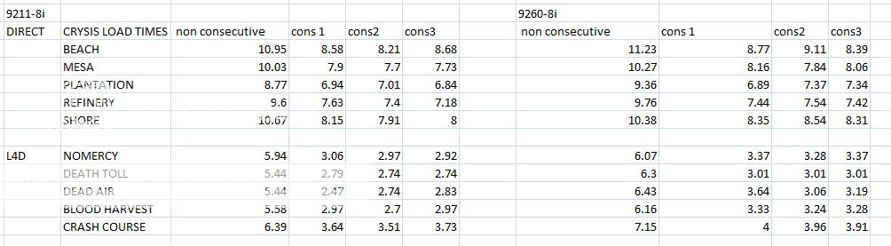

I am having probs with my array, working on it gonna do some trim functions, etc maybe trouble shoot mobo before i do a run. tilt has done some runs with pcmarkvantage that he showed me in msn, and if they were with a good cpu and gpu he would be in the 20k easily. i am not stressing too much on the vantage results though, i have been testing game load times, and there is less than half a second difference between 9211 and 9260, this is with reboots in-between loads so that you dont get consecutive results. however the consecutive results are interesting with L4d what i did is just load the game four times in a row, consecutively. the 9211 beats the 9260 in the consecutive loads by a second on most stages. doesn't sound like much, however the loads only take around 3.4 seconds when loaded consecutively so that is a 30 percent speed difference in consecutive loads. that is very curious considering the 9211 does not have cache. i will post results of those test shortly, once i am sure i have been using the optimum setup. running into the issues with my drives is negating alot of my tests GAHHHH!!! the difference may be more pronounced than what i am showing here.

turd said : excellent this is gonna be awesome the prospect of putting them head to head is exciting! for the 9260 the best for ssd is adaptive read ahead, disk cache enabled, direct I/O, NCQ disabled on the card, always write back, and the highest pcie packet size that your motherboard will allow. pci-e should be clocked to the same for each card. i would suggest 105. the size of any everest test files should be large enough to dissallow cache runs, and the profiles and test sizes of files should be the same. so if you come up with some standard tests that would be great. It is going to be interesting how the various cards handle the sheer power of those acards...i agree a like stripe size should definitely be used so that we can get a good comparison of that. game loads times will be a must, but only for comparison on your system only, as the load times will be specific to your setup.
also pcmark vantage scores should be a big must as well. i think that benchmark is about the best out there for real world usage.
it is going to be hard to quantify which is actually faster in real world usage, as all three are fast as hell also i think you should try to use the crysis warhead as a a good indicator because if it is like the original crysis it has a built in load level timer so that we get a computer score that is not subject to error. stopwatch is kinda...i dunno we are dealing with milliseconds and such! i hope the other games have built in level load timers?
