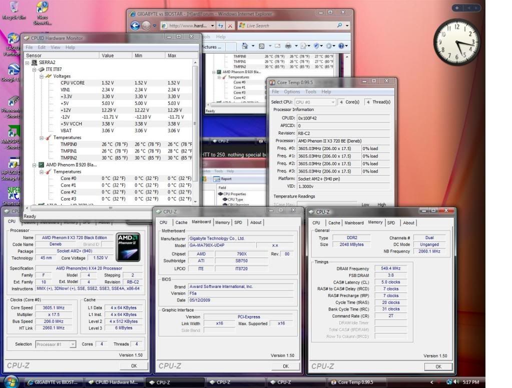

As for Clocking the 720,,
720's can use up to 1.55vid depending on cooling.
A 720 unlocked will get about 3600/3700 stable with around 2400nb .
Ive only seen a few that did 3800mhz on all four cores...My 720 was not one of them that did that 24/7. I could only do small runs with it. it was rock solid@ 3600mhz-3700mhz depending on Nb i used.
it took 1.4+ NBvid and 1.52 CPUvid/vcore to get 3650mhz/2500nb @X4cores
STOCK VOlts UD4P and 720BE.
http://i168.photobucket.com/albums/u...x4coreUD4P.jpg
MAX CPU multi Clock UD4P and 720BE..Note i did not raise the NB @3800mhz ,it would make it unstable. 720's dont clock like a 550 thats for shure.
http://i168.photobucket.com/albums/u...weaking720.jpg
My 24/7 with 720BE,, UD4P i used NBvid +.250 = 1.45vid to get the NB to 2600mhz . That was even unstable so i just settle for 3600/2400nb . If you want a good Unlocker a 550 hands down compared to 720.
http://i168.photobucket.com/albums/u...ng720_3600.jpg
