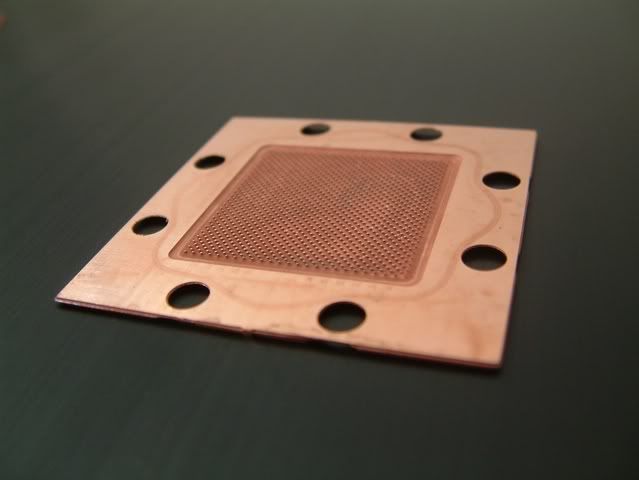

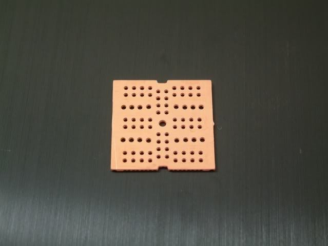

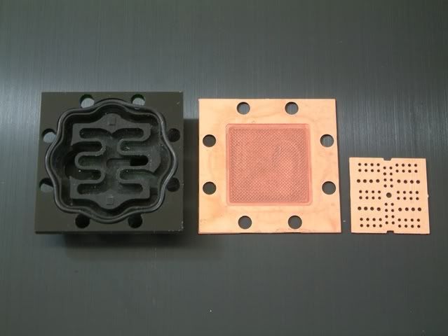

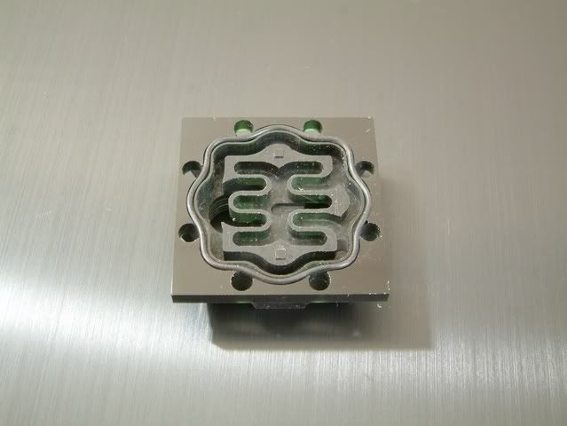

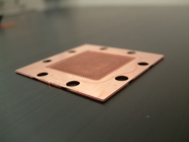

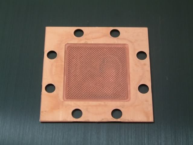

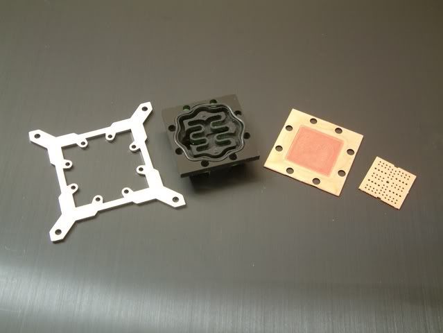

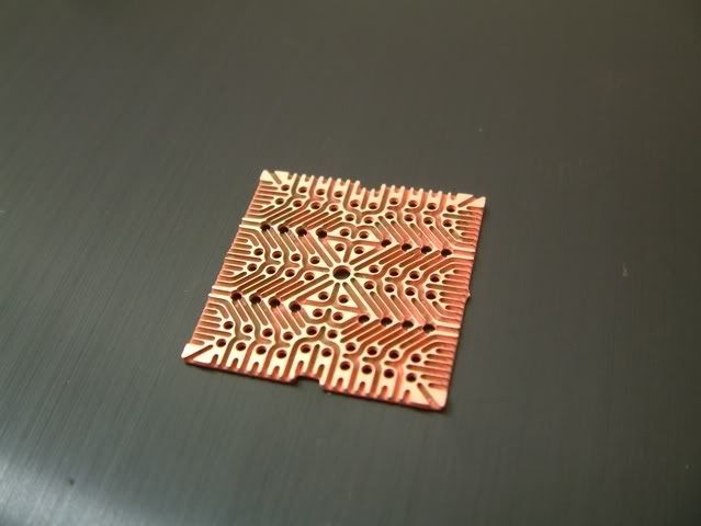

Cool, we look forward to seeing your results! Could you post a few internal pics? The ones at the beginning of this thread are too small to see the flow route.
Internal Pictures :)
http://i179.photobucket.com/albums/w...s/Phobya11.jpg
http://i179.photobucket.com/albums/w...s/Phobya12.jpg
http://i179.photobucket.com/albums/w...s/Phobya13.jpg
http://i179.photobucket.com/albums/w...s/Phobya14.jpg
http://i179.photobucket.com/albums/w...s/Phobya17.jpg
http://i179.photobucket.com/albums/w...s/Phobya18.jpg
http://i179.photobucket.com/albums/w...s/Phobya15.jpg
http://i179.photobucket.com/albums/w...s/Phobya16.jpg
Good pics Marcus!
Did you have any difficulty getting that o-ring back in? I struggled with that thing for a good 20 minutes after disassembling the block for pictures.
highly restrictive, me thinks.
Great pics, marcus!
according to my calipers base plate is just shy of 1mm. the block construction is interesting/different from what I have seen from other companies. I would be surprised to see the plate warp with the stock mounting hardware. There is a slight center aligned bow to the base.
