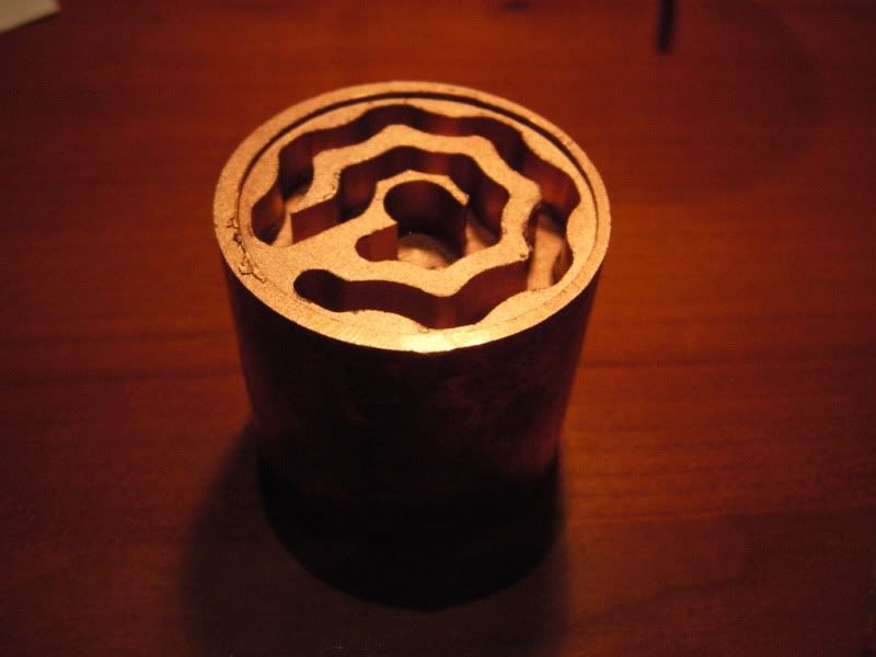

http://i198.photobucket.com/albums/aa15/teyber/evap.jpg
sorry for cheezy photohsop :P
http://i198.photobucket.com/albums/a...r/DSCN2407.jpg
sanded, cleaned but un-lapped evap

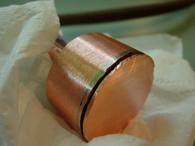

http://img227.imageshack.us/img227/3717/dscn2416dw7.jpg
http://img227.imageshack.us/img227/3...d0ca0130da.jpg
http://img237.imageshack.us/img237/7501/dscn2417ml5.jpg
http://img237.imageshack.us/img237/7...3237d45cdd.jpg
quick lapp to 1000 grit :) almost ready to go... screws i have are about 1/8" to short.... tomorrow at 7 ups delivers longer ones.
