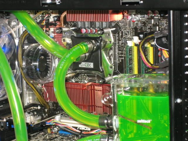

I really like the black inside of the case, BUT we want to see the TEMPS :p:
Karl, why didn't you hard mount the CPU block?
well basically a hardmount allows greater tension control. Also allows a more firmer grasp with a bowed block.
However i got more even coretemps via springs then via hardmount :shrug:
I dont like hardmounting. Its very difficult to get it done right if your board is premounted inside the case.

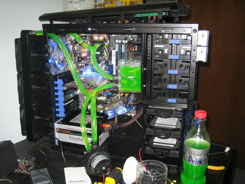

Ok, well obviously everything isn't 100% finished yet. I've still gotta figure out how I'm going to rout the fan cable off the radiator, plus trim down a small section of the left side panel where it rubs against the radiator mounts, install the last couple of fans, and then mount the pump. Plus I still need to install the UV cold cathodes in the case. So far all the lighting is done by blue LEDs on the fans.
BUT, I do have some more pics for you all, now that everything is installed and running.

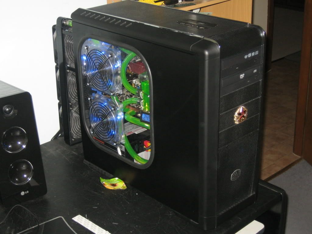

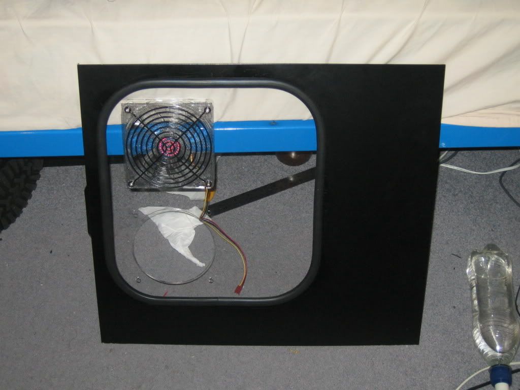

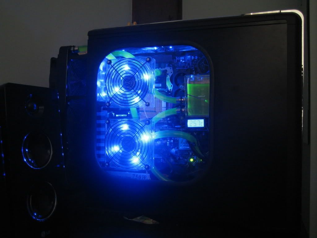

And this is what the window in the side panel looks like:
http://i113.photobucket.com/albums/n...r/IMG_5818.jpg
Still haven't decided if I'm going to mount a second fan in the hole there, or if I'll just put a black grill + fly screen (for a dust filter) and leave it as a vent.
At 3.0Ghz with 1.25v, CPU load is about 50-55°C. I bumped the voltage up to see what kind of voltage I could reach, and 1.45V gets me 65°C load temps, so it looks like that'll be my limit for overclocking.
As for GPU temps, 35°C idle, and about 45°C load.
All of those are with an ambient of 23-26°C.
Oh, and both my Northbridge and Southbridge temperatures have dropped by about 5-10°C. I'm guessing it's because the CPU and GPU are now no longer dumping their heat into the case, which means the NB and SB heatsinks are getting cooler air.
I figured a spring mount is a lot easier to get an even pressure. Core temps are fairly even, and while Core0 and Core1 are higher than Core2 and Core3, that's fairly much usual for quads. I'll have a bit of a fiddle with mounting pressure later, but I'm fairly happy with the results.

BTW, what kind of tubing are you using? Tygon?
NB and SB load temps are about 40°C with the Thermalright HR-05's on them, so putting the NB and SB into the loop would just add restriction and dump more heat into the loop. And considering how bloody hot the Q6600 B3 gets when loaded up, I'd rather not :p:
Yessum, New South Wales man, born and bred.
MasterKleer 7/16" ID tubing. At US$0.50 a foot, it's hard to pass up :p: For the money that Tygon tubing would cost I could get enough MasterKleer to do my loop 3 times over :p:

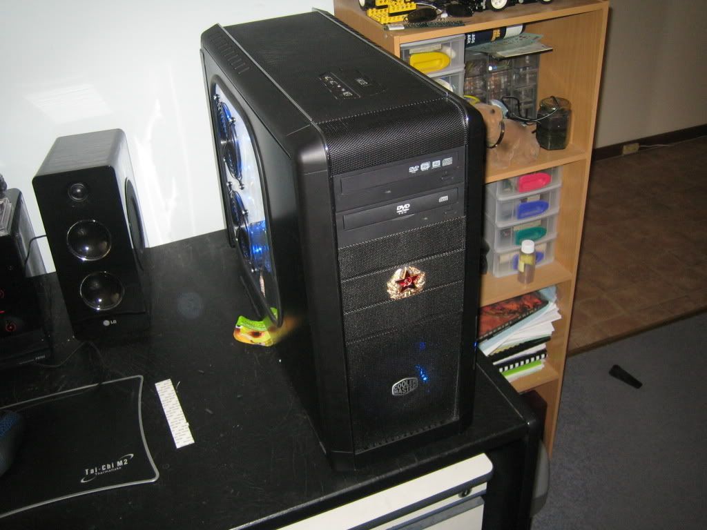

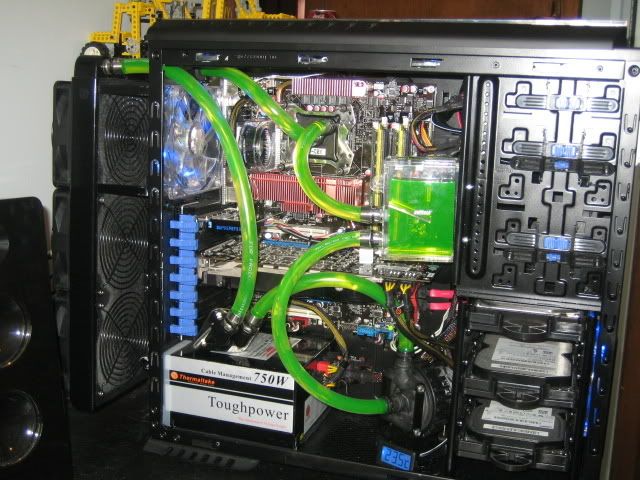

Sorry I haven't updated in a while, things have been a bit busy what with everybody moving out, plus Christmas.
Things aren't quite 100% finished yet :p: However they're certainly getting there. Still need to route the radiator cables inside the case, and tidy up things around the back a bit (it's a bit messy :p:).
However this is going to give you an idea as to what it's going to look like when it's all put together:
http://i113.photobucket.com/albums/n...r/IMG_5844.jpg
http://i113.photobucket.com/albums/n...r/IMG_5842.jpg
http://i113.photobucket.com/albums/n...r/IMG_5850.jpg
I love how neat and tidy that window panel turned out. Well worth the AU$30 it set me back.
It's almost finished! :D Then I get to clean up my room, considering how much of a mess it's been lately :p:
Eller
Yeh the side panel looks realy good, and the fans should give your mosfets some nice breeze.
Where did you get it cut, looks well done?!
awesome build!! the window mod looks great :)
yea look great, where did you get that trimming for the cuts you did on the MOBO tray?

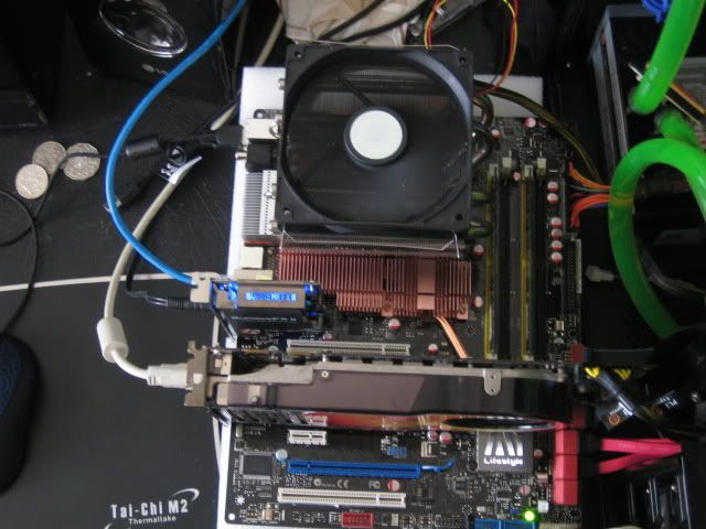

UPDATE

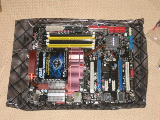

Sorry about the complete lack of updates recently. I had originally intended to reserve my final update until after I recieved the final HR-05 IFX for my northbridge, but then I had a minor mishap. I tapped my CPU block once while it was running, and that somehow managed to kill my 680i board.
So, I now have a new motherboard: Asus P5E x38 board. And let me tell you, this board is a hell of a lot better than the eVGA 680i A1 was. I can actually get this one stable up to 3.6Ghz, while the 680i would become horribly unstable as soon as I tried to go past 3.0Ghz.

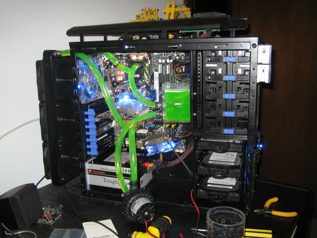

So some pictures:
http://i113.photobucket.com/albums/n...r/IMG_5877.jpg
http://i113.photobucket.com/albums/n...r/IMG_5878.jpg
http://i113.photobucket.com/albums/n...r/IMG_5880.jpg

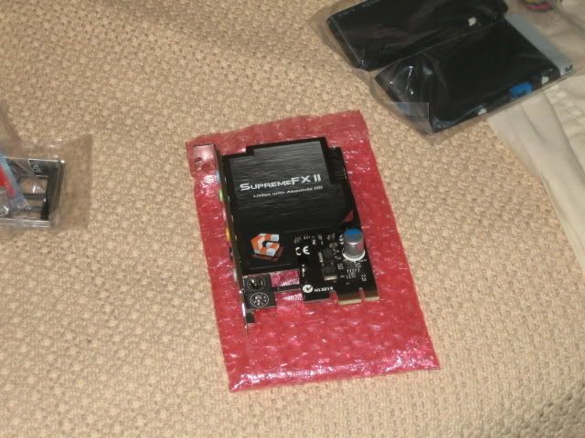

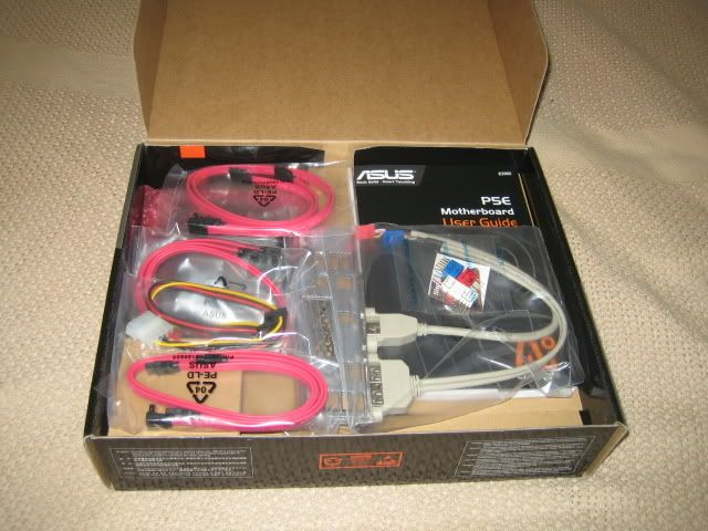

The nifty little SupremeFX II soundcard that comes with the board:
http://i113.photobucket.com/albums/n...r/IMG_5881.jpg

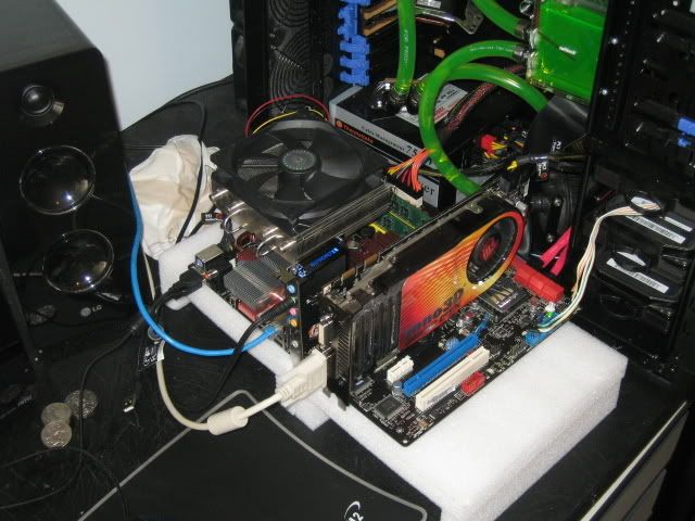

Set up as to test the board and make sure everything works properly:
http://i113.photobucket.com/albums/n...r/IMG_5887.jpg
http://i113.photobucket.com/albums/n...r/IMG_5891.jpg

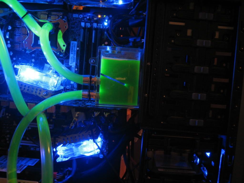

And now back in the case:
http://i113.photobucket.com/albums/n...r/IMG_5892.jpg

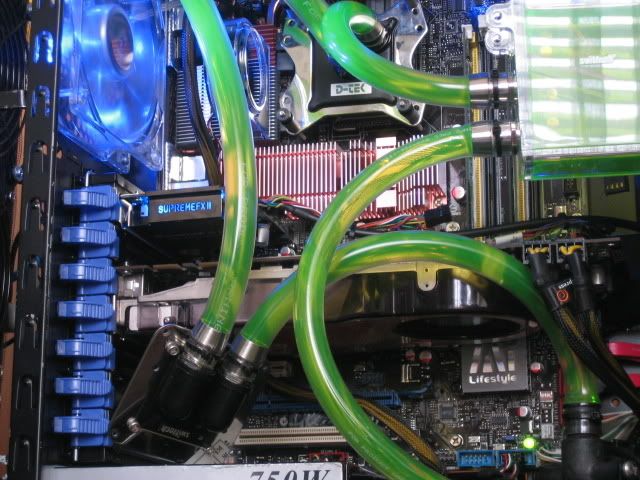

Yes, the GPU isn't in the loop when I took this photo, since I took it out to see what happened to CPU temperatures.
http://i113.photobucket.com/albums/n...r/IMG_5893.jpg
http://i113.photobucket.com/albums/n...r/IMG_5899.jpg

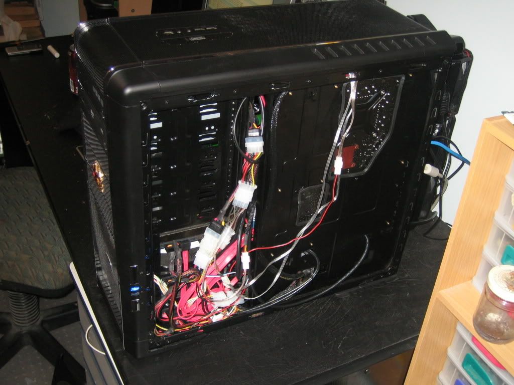

The mess of cables at the back of the case:
http://i113.photobucket.com/albums/n...r/IMG_5903.jpg
I can hear you asking how the hell I plan on getting the side panel on with all those cables there. Well, I wasn't sure myself, but I did manage to do that:
http://i113.photobucket.com/albums/n...r/IMG_5916.jpg

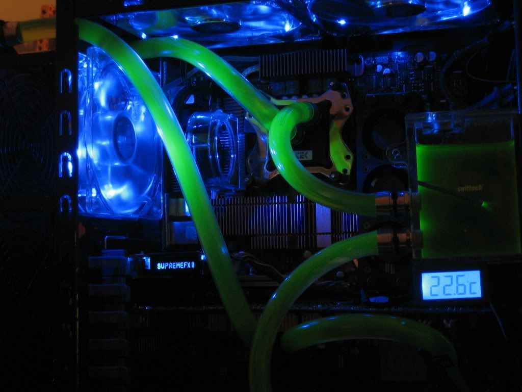

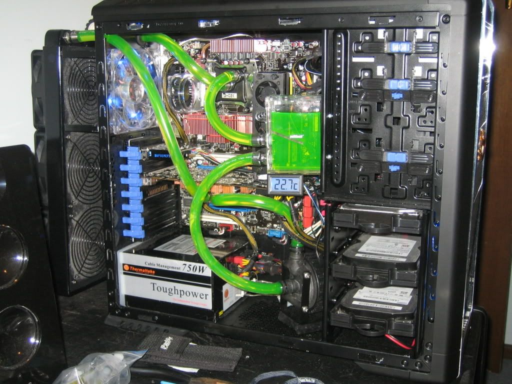

With the GPU back in the loop:
http://i113.photobucket.com/albums/n...r/IMG_5912.jpg

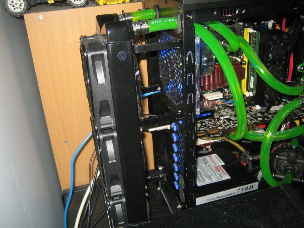

A pic of the radiator mounts. The scratches were from where the side panel was hitting up against it while I was trying to put the side back on. The panel has now had a couple of notches cut out of it to make sure it clears the brackets. I need to touch up the paint there a shade.
http://i113.photobucket.com/albums/n...r/IMG_5915.jpg

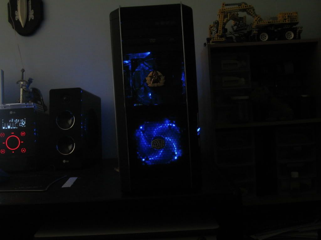

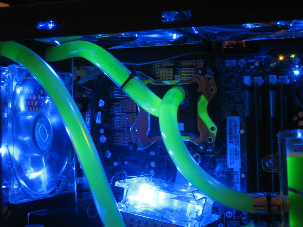

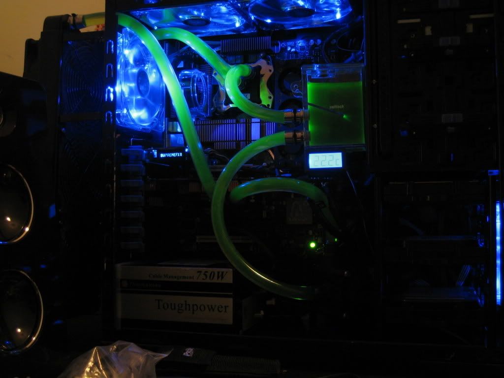

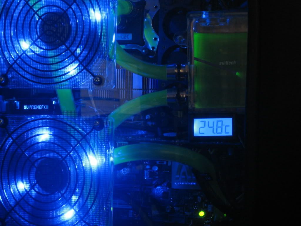

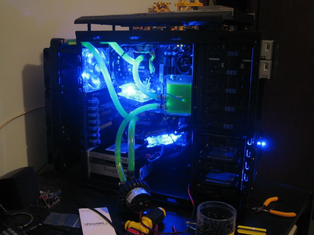

Some dark shots. Since I no longer have LED fans on the NB and SB, I think I might need to invest in some UV or Blue cold cathodes or LEDs to lighten things up a bit.
http://i113.photobucket.com/albums/n...r/IMG_5918.jpg
http://i113.photobucket.com/albums/n...r/IMG_5922.jpg

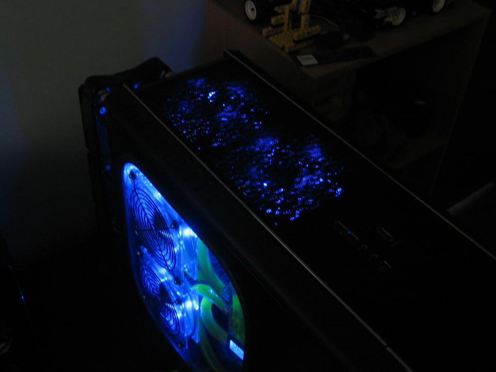

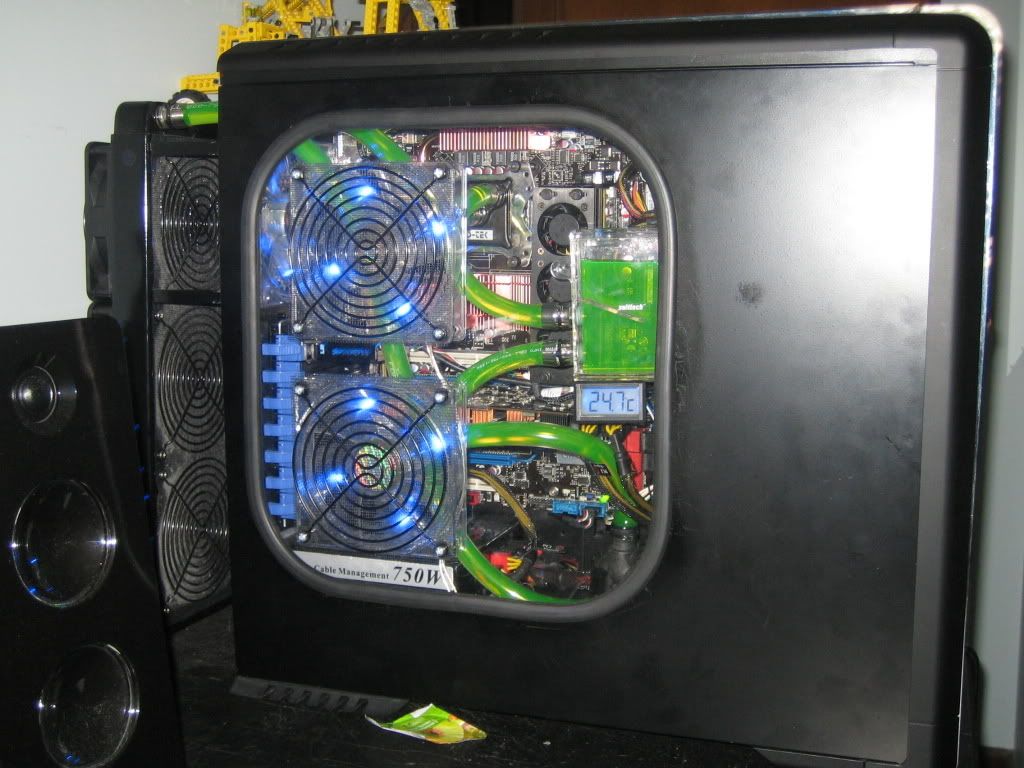

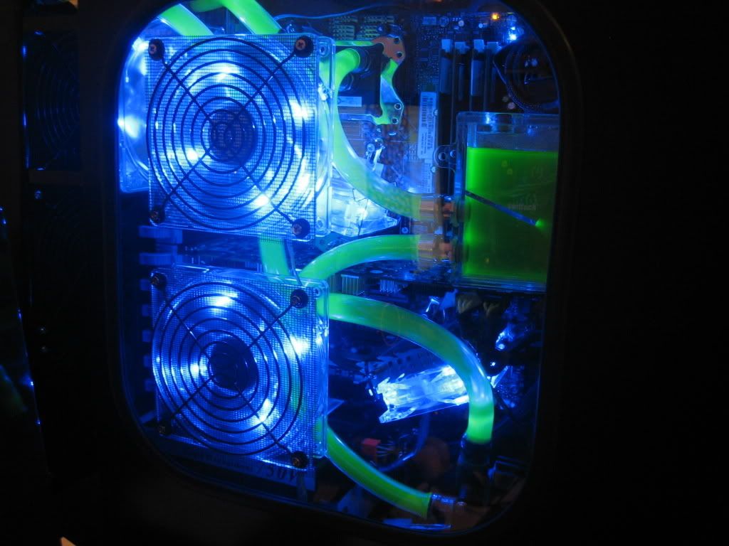

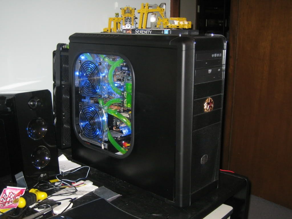

With the side window on:
http://i113.photobucket.com/albums/n...r/IMG_5924.jpg
http://i113.photobucket.com/albums/n...r/IMG_5925.jpg
http://i113.photobucket.com/albums/n...r/IMG_5926.jpg
http://i113.photobucket.com/albums/n...r/IMG_5930.jpg
http://i113.photobucket.com/albums/n...r/IMG_5928.jpg
http://i113.photobucket.com/albums/n...r/IMG_5931.jpg
http://i113.photobucket.com/albums/n...r/IMG_5933.jpg
And I think that's the end of this work-log.
I'm pretty happy with the water loop, although there are a couple of peculiarities with it. Currently I have my Q6600 B3 running at 3.52 Ghz with 1.512v after vDrop and vDroop, and I get load temps of 68-70°C. However this doesn't change much with ambient temperature, and also doesn't change at all if the GPU is out of the loop. But, I can live with that (especially considering how low my GPU temps are), so I'm happy.
I'm also pretty content with the stock cooling on the motherboard. I never see NB load temps higher than about 40°C, and the heatsinks on the mofsets are warm but not hot to the touch, so handling the voltage a lot better than my 680i was.
Currently using the 502 BIOS for my P5E, and it's stable at 3.52 Ghz, although I'm thinking of going back to the 107 BIOS, since I could get it stable at 3.6 GHz with the same voltage.
And I've also found out that my Corsair Value Select PC2-667Mhz RAM can manage to do 800Mhz 5-5-5-15 timings with a voltage increase. It's currently running 2.0v (and before you freak out, the RAM has a fan over it), although I'm pretty sure I could probably drop it somewhat (maybe 1.9-1.95v), but I'll work on getting my CPU overclock stable first.
I bought the window kit from www.pccasegear.com.au, and then installed it myself.

Nice, I like the little temp monitor under the res.:up:
:) Very nice! I love your setup! I have a very similar setup and will be modding a window to my side panel as well! :D
