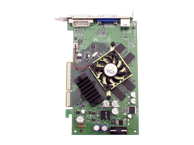

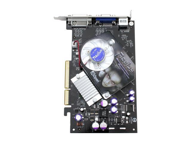

EDIT: hey, i was searching for the 6600 256mb cards... just to compare to my card.
Ok, watch...
EVGA GF 6200 256MB/picture: http://images10.newegg.com/productim...130-226-02.JPG
Now see AOPEN GF 6600 256MB AGP, the only difference it is the cooler... even the capacitors are in the exactly same position... http://images10.newegg.com/productim...135-169-02.JPG
And in last, but not less important... hehehe, the chaintec 6600 256mb AGP... exact the same has the evga 6200 256mbhttp://images10.newegg.com/productim...145-112-02.JPG
So... i was thinking, all these cards have the same core, even the 6200... and they are so similar...
there is no why for a bios change to make the 6200 work like the 6600.
what you think guys? :D
you're absolutely right GSJ - all 6200/6600's use the exact same core and exact same PCB design, which is why vmem and vcore mods are universal for these two cards. The only time it changes is at 6600GT which uses the same core but different PCB design due to the fact that it has GDDR3 and needs different power specs. The bios is a very strange thing though, and i don't know why. When i flashed my card to a gigabyte 6600 w/128mb ram it simply booted into windows as a "NV43" and not a geforce 6600 or 6200..i actually had to force a driver install to get it remotely close to working. even then it was all screwed up, so i just flashed back. I"m not sure of results other people would get from flashing however, so if anyone feels like giving it a shot, let us know what happens :)
