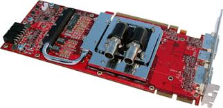

Swiftech Gabe or Stephen question for you guys
I am wondering if Swiftech is working on a new block for the Nvidia GTX 670 short PCB card? (NOT LONG) I was wondering if you guys plan on building something like pictured below like you did in the past for the 4870 GPU?
http://images.anandtech.com/doci/5818/EVGAPCB.jpg
http://www.performance-pcs.com/catal...60-4870_01.jpg
http://t3.gstatic.com/images?q=tbn:A...ymKCdMySEw&t=1
http://t2.gstatic.com/images?q=tbn:A...yNlkHsKG1u&t=1
Or is it going to be something in the lines of this below?
http://www.swiftech.com/images/HD5850-MVW60.jpg
