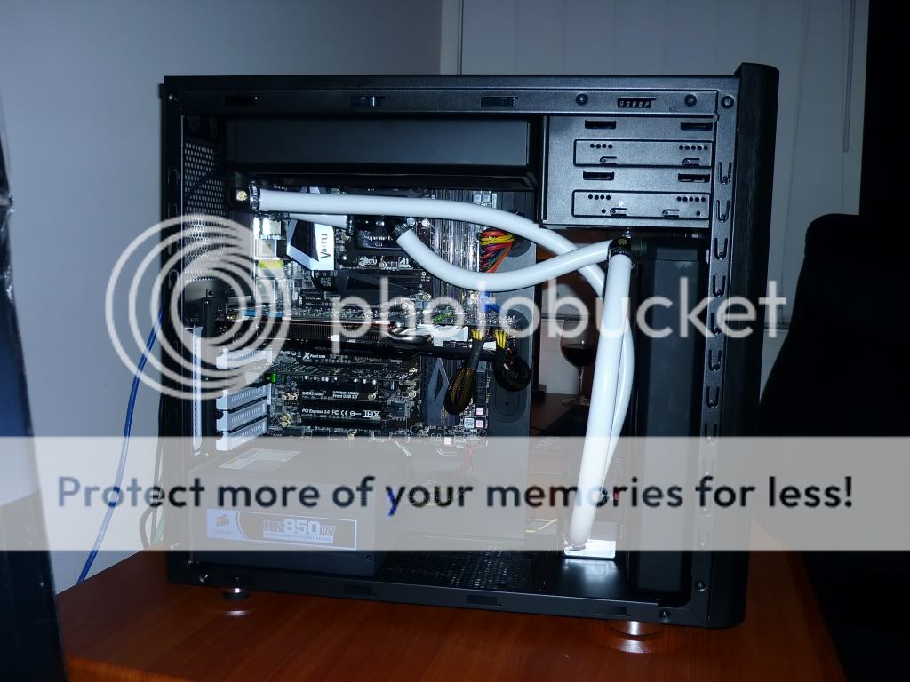

I'm pretty disappointed with my i7-2600k temps on this board. I might revert the BIOS to an earlier version.
at 4.9Ghz I need 1.47v and it loads at close to 80c - custom water (240mm + 280mm)
4.8ghz is much more tolerant as it only needs 1.41v. Maybe I need to increase voltages elsewhere, but I kept getting 000000101 BSOD's until I increased the vcore to this point.
Maybe I just got a 2600k that doesn't overclock too well. I've reseated the waterblock a few times which didn't help either.

Hitting stupidly high temps on water at anything above 4.6Ghz+. This board kicks out allot of heat into the system as my system temp (measured by a seperate probe from my Aquaaero 5) shows. IBT on standard ALWAYS goes upto 80Degrees C no matter the volvts I've used so far - 1.32 > 1.52 which is quite wierd.
PLL is always at 1.8v on this board. I'm pretty depressed my 2600k can't even do 4.6Ghz without sooo much heat especially under water!!!

Cooling I've managed to resolve (I think) as my fans on my rad wern't spinning up to full speed - sorted now.

Looks like my problem with heat was a poor 2600k. Got me a 2700k today which is running happily @ 4.6 with 1866 ram on only 1.28volts using the standard Turbo 4.6 profile on this board. Sorry asrock pls forgive me lol :)
