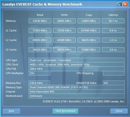

Better RAM Timings(still a little toasty on air with a TRUE):
http://i246.photobucket.com/albums/g...Better1156.jpg
Everest Latencies:
http://i246.photobucket.com/albums/g...verest1156.jpg
you serious mate?? on a T.R.U.E.?!!!?!!!?!!!?!!!?!!!:eek::eek::eek::eek:

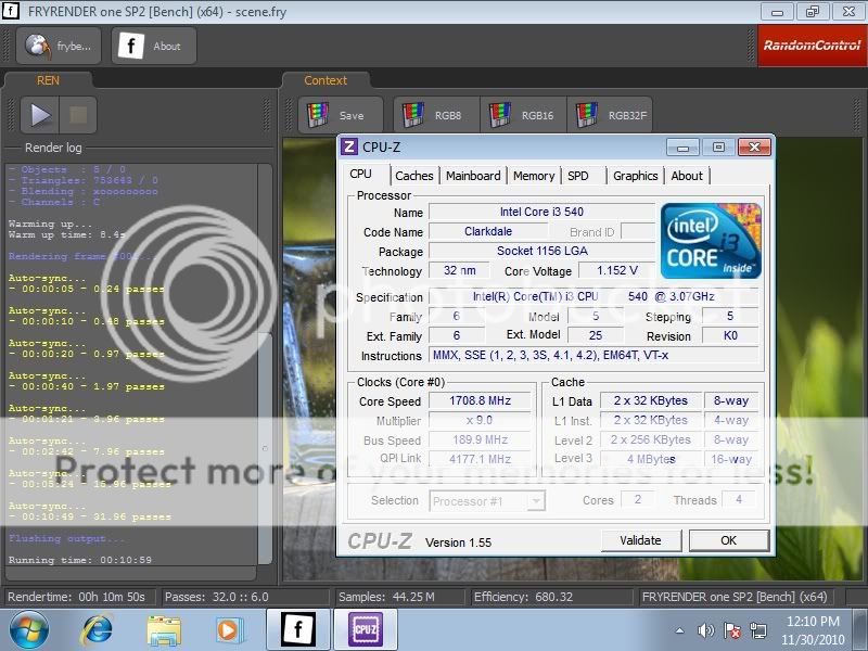

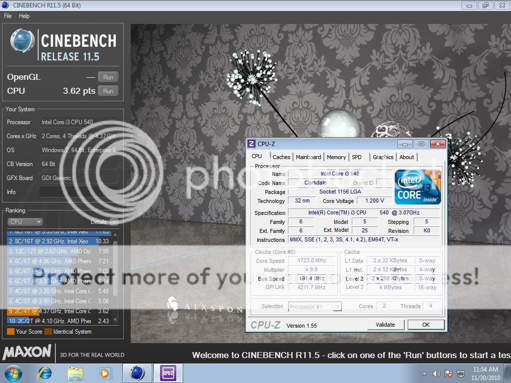

Core i3 540 L025B058 4370MHz @ 1.48V
I decided to try something small and hideous for overclocking... ECS H55H-M :)
http://www.pahing.com/wp-content/upl...ECS-H55H-M.jpg
Despite the price and lack of settings it managed to perform very good.
I managed to get max bclk of 190 MHz
CPU-Frequency 4370 @ 1.48V
DDR 1900 8-8-8-20
I was able todo this just by setting
CPU/VTT +0.2
DDR +0.13
CPU/Vcore +0.2
The actual frequency is 4370 @ 1.48V
http://i701.photobucket.com/albums/ww15/koev87/cine.jpg
http://i701.photobucket.com/albums/ww15/koev87/fry.jpg
http://i701.photobucket.com/albums/w...apImage6-1.jpg
Even when overclocked the energy saving functions worked fine, the voltages are stable, just the bclk plays a bit,but it'snot a big deal.
