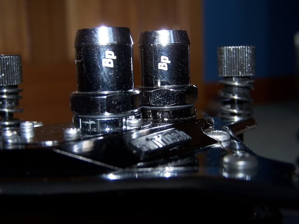

I'm having an issue with my Apogeee XT, I reversed the inlet so the BP black matte compressions would fit properly, the compression screws into the inlet hole fine but the compression fitting is very very tight in the outlet hole and it just refuses to go anymore. I don't know if this is a manufacturing fault or what since on your website it does have a picture with two compressions on the block.
Any help is appreciated. :)
EDIT: I am using Bitspower 1/2" Black Matte Compression Fittings.
Hi there.
I have met with the same problem as Sil2.
However, I changed to an older BP fitting I got earlier and it screwed in perfectly.
I believed it is the BP fitting I was using, as I tried Swiftech fittings and other BP fittings and they worked perfectly.
I am also having the same issue that GregSG and Sil2 are having. I just ordered the BP fittings. They work fine in the inlet as the others have said but will not screw in all the way on the outlet. The provided fittings with the block fit ok. I tried the same fittings in my radiator, reservoir, and pump top and they screw in with out any issue. The fittings I have are the Bitspower G1/4" High Flow 1/2" Fitting - Black Matte Finish.
*Edit: I opened and tried all 10 of the fittings I ordered and 2 out of the 10 manage to snugly screw in all the way with a fair amount of resistance.
I am in the exact same situation (XT block, BP fittings). The outlet on my XT is a lot more "picky" on which fitting i can screw in.
I took the fittings that I used for the pic below, and tried them with several blocks. I didn't encounter any problems. I don't really know what to say. It looks (at least from 2 out of 3 posts) like the chrome fittings work fine, but the black fittings don't. Maybe a different production batch at BP?
http://www.swiftnets.com/assets/imag...ING%20X300.jpg
There are only 3 threads on these fittings. I don't think it's a problem to use a pair of pliers to tighten them to open up the thread towards the end a bit.
Yeah I just received an XT and BP True Silver screw in no problems on in/outlet

Does not sound good lol i just ordered 10 of the BP black compression fittings :S and i have my swiftech XT in the box next to me right now.....Beautiful block i must add and damn does it way alot more then my old V2 and is way bigger.
I actually had an issue with Primochill Ghost fittings (not the polycarb compressions, the metal 1/2" fittings).
I forget if it was inlet or outlet though, and the block is in the possession of someone else at the moment, sorry.
I just wanted to add in case you have the ability to test those as well. I believe it was the outlet if that makes a difference.
Gabe, black fittings are slightly thicker on the thread, I've had a few issues where the fittings is hard to put in any block but once it's in, it "flattens" the paint/whateveritis on the thread and makes it easier to screw in next time :)
Sil's problem may be different though.
I ordered one as it was on sale at Petra's and it came missing a screw! So since I couldn't install it I went with the HeatKiller Cu I had in my draw (I have a collection of heatsinks). My biggest reason for buying the XT was for the ability to use compression fittings. However using 7/16 Tygon on 1/2"" double lipped fittings with snap on black plastic clips seems secure and tight on the heatkiller. Guess I'll install the XT one of these days on my next build or just use it as a paper weight... Looks pretty though...
Gabe,
Received my block today and same deal with the inlet thread with a BP True Silver.
I wouldn't say the thread on the BP's are out of spec I did look at the bloc and the thread inlet and thread outlet are not machined by the same tap at least on my sample. The inlet on mine looks almost double taped, the thread pitch is the same but where the main thread should form and apex or be flat its got a fine thread instead.
On the BP fittings when you place them to start the thread there is a very fine start to then the normal pitch. There is far less play with the BP threaded in either hole 2-3 turns in than the barb fittings and the Barb fittings have a much finer pitch of thread, they slap all the way down to the O-ring. I have one BP that wont feed into the inlet, but all of the rest will. When they are in they fit nice and snug no cross-threading threat unless you are careless.
I have some pictures but they aren't really clear, but there is definitely a difference in the machining of each hole. I fully expect mine to work as intended and I will use the BP fitting as its a nicer fit. Not a huge deal for mine but people should know there is less tolerance in the BP threads than the barbs at least on my example, I prefer the BP thread the way they currently are.
Hope this offers some help
So people cannot get there fittings to stay on or are they noticing leaks? im not user whether to use the stock 1/2" or my beautiful bitspowers now with this issue (hopefully mine has none of this problem though).
if it is just the black ones i would have to say that it is something to do with the anodizing of the fittings (maybe not as anodizing is VERY thin) just throwing it out there

The guys with the issues here including me have the Bitspower G1/4 1/2" Black Matte Compression Fittings. :)
Well i could not use my black sparkle 1/2" compression fitting in the inlet but could in the outlet???
bit weird.
But none the less i used the normal swiftech barbs and there fine and what can i say this block is AMAZING.

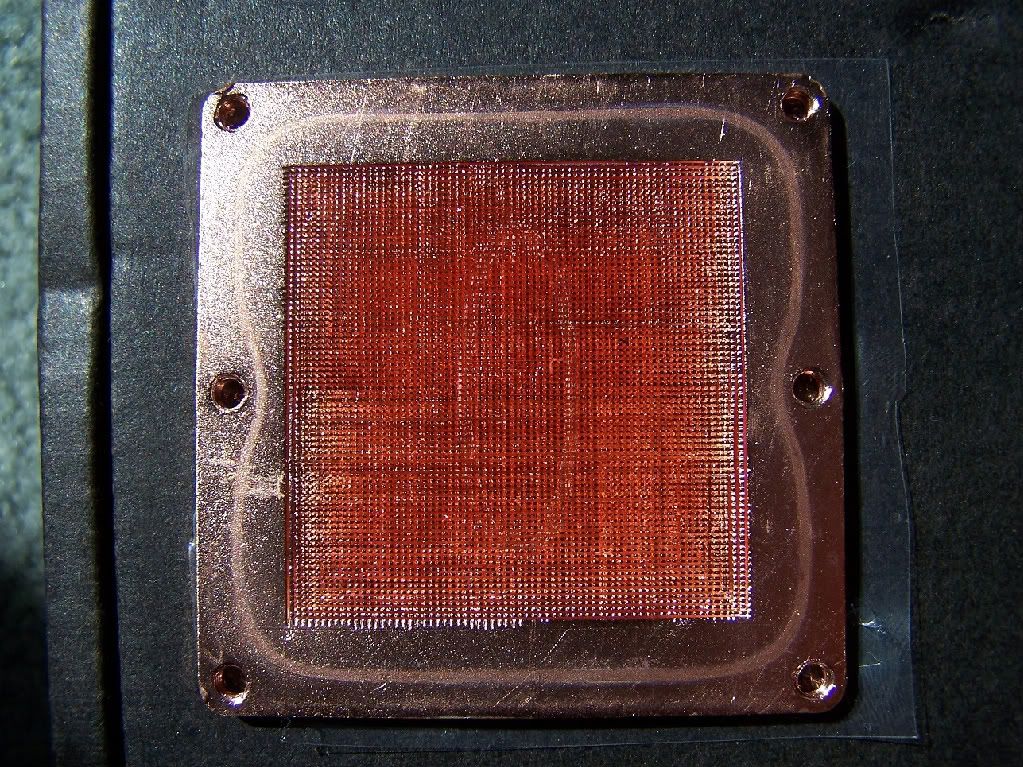

Received my block this evening.
http://i399.photobucket.com/albums/p...omputer_59.jpg
What do you think of this guys? :shrug:
http://i399.photobucket.com/albums/p...omputer_63.jpg
Oh and another thing, why would two of my screws look like this and two look normal?
Clean versions look like this:
http://i399.photobucket.com/albums/p...omputer_66.jpg
and the two dirty ones:
http://i399.photobucket.com/albums/p...omputer_65.jpg

Here's a shot with my fittings installed.
http://i399.photobucket.com/albums/p...omputer_70.jpg

Funny thing is, I can still sort of fit a Swiftech fitting, but BP there is no way in hell to fit it. All other ports are good. Not sure what to do now...

Just received one of these lovely blocks today. Looks like I got a very good sample. I think I saw a whopping two pins noticeably out of place, and even they were so hard to photograph I can't tell which ones specifically.
http://www.myalbumbank.com/albums/us...0/12-pins1.JPG
Here's the high res version if you want to try and find them.
Pics of the exterior in the parts gallery here if you're interested.
