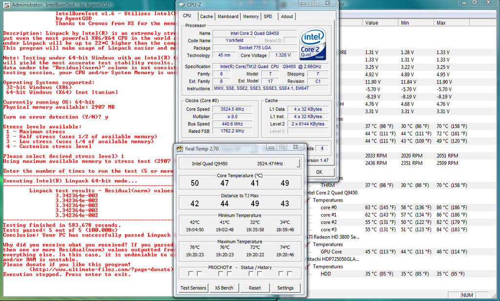

My Q9450 C1 result done today on a very hot humid day.
http://i173.photobucket.com/albums/w...RUE_IBT_OK.png
A Qns
