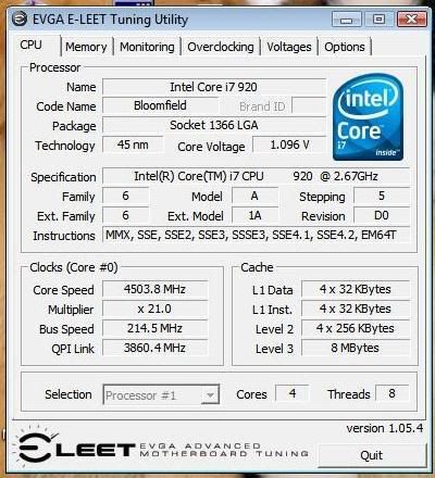

[QUOTE=unclewebb;3938042]Scooby: Your screen shot clearly shows turbo throttling. Your multipler is at 20X at full load which equals about 4308 MHz.
At idle it jumps back up to 21X or 4523 MHz but it's not running at that speed at full load.
You need to make an adjustment in your bios to get the 21X multi to stick at full load.
Check out RealTemp 3.30 and i7 Turbo V8 so you can watch your multi at full load.
Unclewebb,
i7 Turbo has EIST grayed out and core 1 throttles. EIST is disabled in the bios of my GA EX58 UD4P. How do I get the 21X to stick?
Thanks
Both C1e and EIST are disabled.
Yah
the interesting thing is that EIST shows with a check mark in i7 Turbo 6.5 and is grayed out.:shrug:
