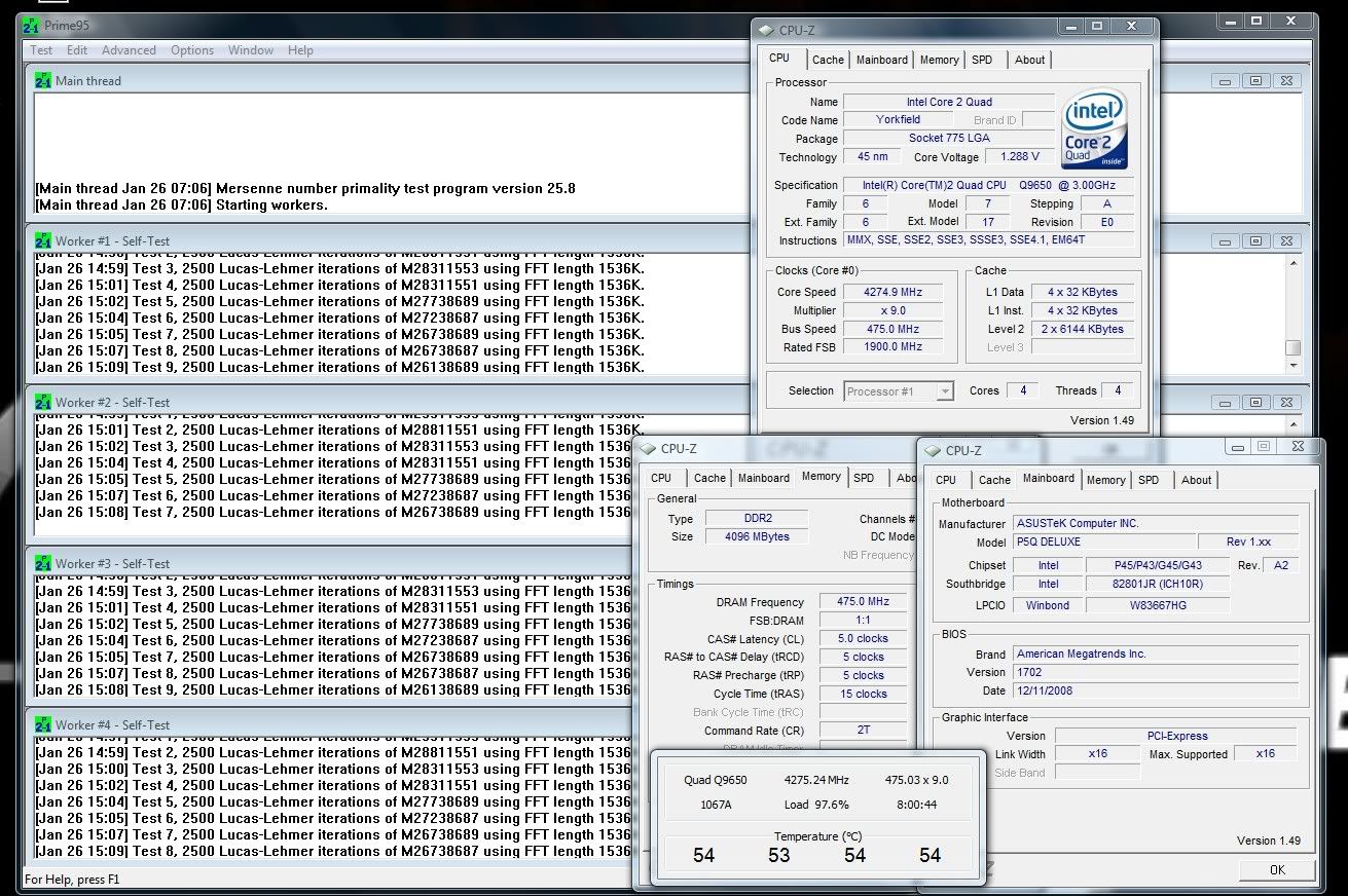

I think I've found my 24/7 speed :up:
Stability tests:
http://img265.imageshack.us/img265/3539/ibtaiv5.th.jpg
http://img265.imageshack.us/img265/7505/occtaix8.th.jpg
http://img265.imageshack.us/img265/1...mpsaka7.th.png
3d stable:
http://img153.imageshack.us/img153/2096/06aas6.th.jpg
http://img89.imageshack.us/img89/144/am3awv6.th.jpg
I ran Intelburntest twice in a row and it passed both times, then I immediately ran occt 1hr and it passed. I also ran p95 for a little over an hour with no problems but stopped it because I don't like long stability tests. 3dmark06 and am3 were run twice as well.
Based on all this, it isn't necessary to run p95 for 24 straight hours right? My rig's in my bedroom and I wouldn't be able to sleep with the noise lol.
Ya, basically people say that OCCT for 1hr is like 10 hours of Prime95.
if you've passed OCCT, and IBT I think you're fine.. but common, you only have like 80mhz to go.. I KNOW you can get to 4.0 Ghz for your daily runs.
