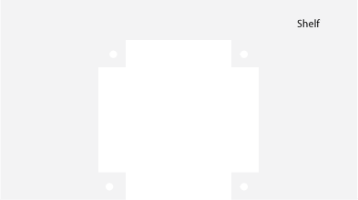

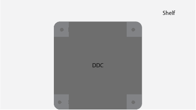

Thanks, Hannibal. I appreciate the advice, but I have to say that I'm not yet convinced that I need to clear the shelf out from under the pumps. These pumps come with two mounting tabs to the base (I've actually shaved these off) for mounting them to a flat surface. So I'm not sure why mounting them to shelves would pose an unusual problem? The chamber will be vented so that all the hot air doesn't just hover around the pumps.
This is an unorthodoxed build/design, but I sincerely believe that all the design choices will begin to make sense soon. Thanks for your feedback. :up:
I'll keep your suggestion in mind though and may do some further research into this before the shelf design is complete.
