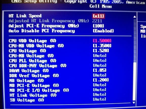

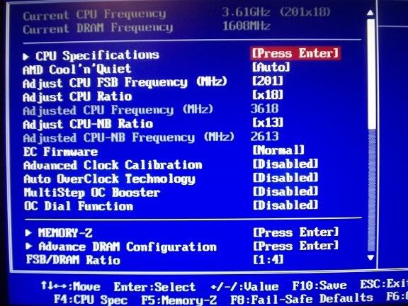

heres some screens of my bios settings, id actually like some help regarding overclocking more than unlocking the 4th core because it seems like msis bios is too buggy for now to even bother with it
but id like to get my system to push out each ounce of performance as possible
NOTICE: i do have the multiplier dropped one notch to run at 3618 right now, i usually keep it at 3718 but it seems my cpu voltage is a bit high compared to what other people report settings theres to to achieve the same overclock
so what can i tweak to get this thing running at its max, one thing is my ram, this crap WONT overclock beyond 1608. its 1600 stock btw ocz flex ex series 7-6-6-24 timings

you will notice in my voltages pic below i have the ram running @ 1.85 volts, itll do 1600 at 1.8v too, but i just keep it at 1.85, but even at 1.95 it wont overclock and be stable above 1608..................the blue screens im getting im almost positive are related to my ram overheating. these things get so hot you cant even touch them for a split second while playing games or benching and ill just get random blue screens ...and it only happens during gaming or benching. but my cpu is prime stable on cpu only tests even at 3718 with the settings you see in the bios pics below. but id like to figure out how to run this thing with lower voltages to the cpu,, possibly by raising the cpu-pll or other settings im not too in touch with at the moment. so some help form you guys would be much appreciated.
720be cpu btw
http://i214.photobucket.com/albums/c...s-settings.jpg
http://i214.photobucket.com/albums/c...bios-volts.jpg
edit: i forgot to mention, regarding ACC.............even with EC set to normal, if i enable ACC i get FF on boot. i know this is a bug in the bios because the early revisions (specifically 1.3 final i recall) didnt do that

man i lost count how many times ive tried flashing the bios. ive used every release since 1.0. ive had the board since it was released
i just found out the other day about this bug when i enabled acc by accedent and realized what i had done as soon as i restarted and was stumped as to why i got a ff then realized i enabled acc

Lover your hht speed to 2400 and set your ddr vref voltage to follow the ddr voltage and set the cpu ddr phy voltage to times up and try again

my ht speed is 2211 if i remember correctly , i read over at ocz's forums having your ht speed at stock 2000mhz is faster in performance benchmarks as opposed to raising it.....doesnt make much sense to me, but is this true? lower = better on ht??? hmmmm
as for ddr vref voltage, what exactly is that used for? same for cpu-pll, what is that for and whats a safe voltage for the 720? whats the benefits of over-volting it? will it help with higher overclocks?
id really appreciate it if someone could explain the cpu-pll and ddr vref for me. thanks in advance to all who help out here in this thread. you guys rock
