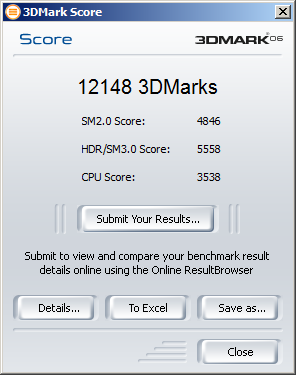

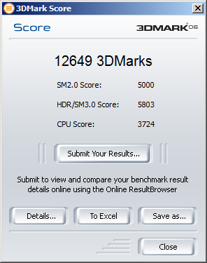

Something majorly wrong there bud, your scores are very low for even 2.6GHz.
3563 CPU is what I get with a 9500 at 2.42GHz: http://img73.imageshack.us/img73/453/2k62420bo4.png
:confused:
Very far from higher MHz perf. 2.68G hits 4k.
2990MHz hits around 4400: http://img233.imageshack.us/img233/8956/2k62990sb3.png
The difference is probably due to the resolution I did the test at. I stated it so there'd be no mistake about directly comparing my scores to "normal" ones. The monitor on that machine maxes at 1024x768 while 3DM defaults to 1280x1024. Because of that, I had to run at a lower, non-standard resolution.
Also keep in mind that 3DMark doesn't serve very well as a CPU benchmark. Other workloads will benefit more or less from the multiclocked config--your mileage will vary. Besides, if the extra speed is free and you can see it manifest, why not take advantage of it? :)
We know its not exactly a good CPU bench but for the intended purpose here, 2k6 can show the CPU speed very well actually as it scales with it. Thats how we can compare it to one another ;)
I'll check out the lower res results and see what it gives, if it has any quirks.
