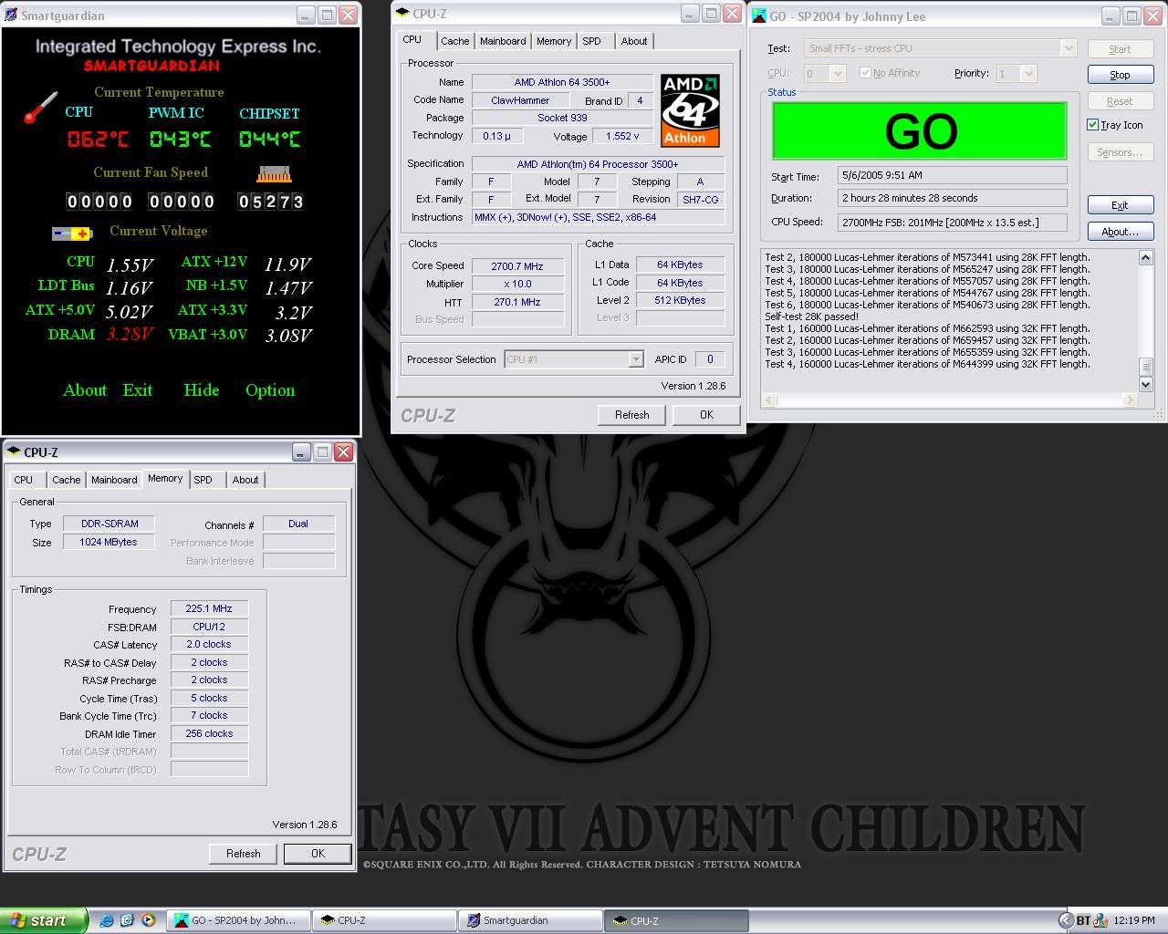

Mine is caa2c 0508APMW FYI. It will do a 2650 overclock running games fine.
