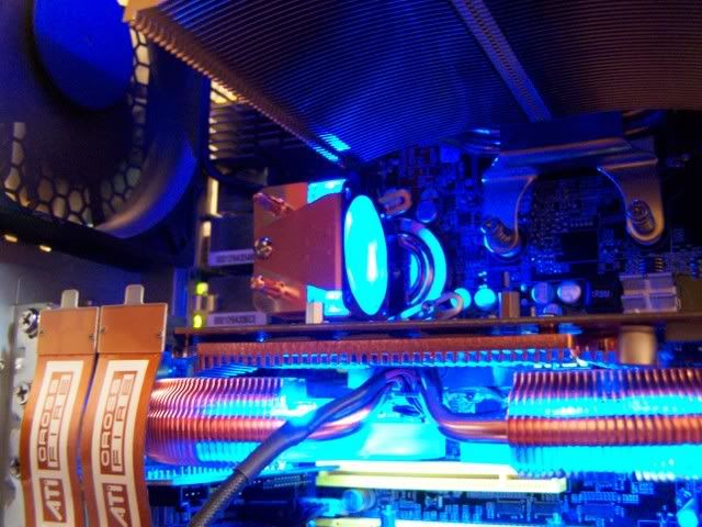

i put this thermaltake sucker on my board and temps got cut in half
http://i22.photobucket.com/albums/b3...y/100_1276.jpg
Pepsi, got any pics of your board with the HR-05?
