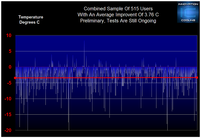

Updating my charts this weekend and hit the 500+ user tests milestone. Raw data chart, haven't broken out he individual competition compounds yet, getting a little crowded
http://i291.photobucket.com/albums/l...ultsupdate.png
