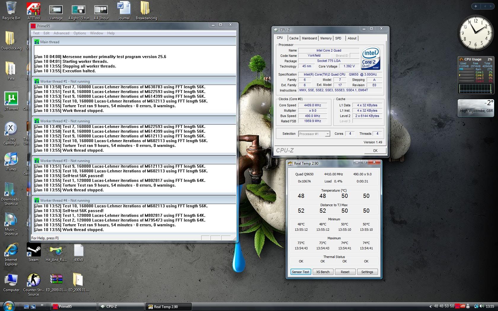

My 3d Mark 06 run:
http://i207.photobucket.com/albums/b...h_3dMark06.jpg
However failed prime small overnight last night after about 5 hours on one core, nudged vcore to 1.39375 this morning but yet to re-run, very close to full stableness :)

So far so good. You mentioned you ran Prime Small overnight im assuming you mean small FFTs? Can you please run Prime Blend if you don't mind?

It was small FFT's i was testing. Before it used to always fail blend within the first self test but since putting in the CPU and NB skews it passed 2 self tests. Went to try IBT and BSOD, upped voltages on CPU and NB and did the 15 run test above. Left it doing the small FFT overnight and was going to do blend tonight if it passed but failed after about 5 hours, will blend it once CPU has passed priming ok though have been on PC all day and not had any crashes or issues (so far!)

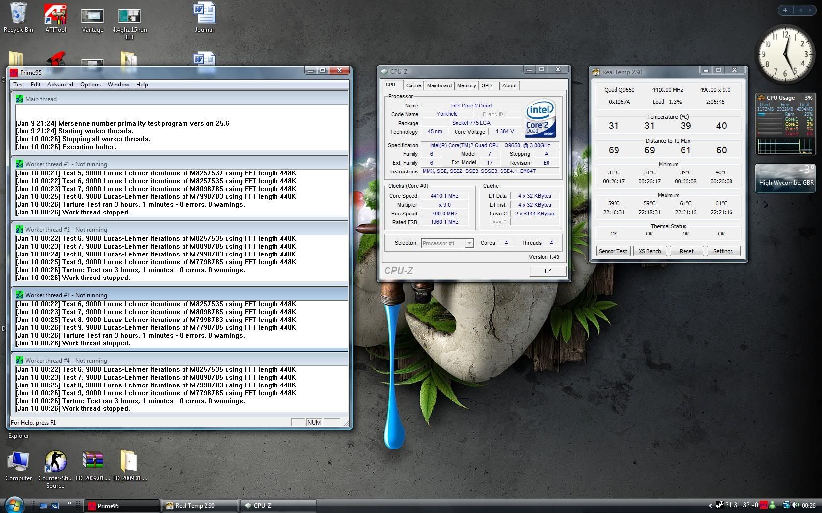

EDIT: here is 3 hour prime blend stable - got bored and played some CSS after this long :D
http://i207.photobucket.com/albums/b...3hourblend.jpg
Nice work.. at only 1.38v.. whats ur vcore set to in the bios?

I left it running Prime small FFT's to retest the nudge in the vcore and passed practically 10 hours of it:
http://i207.photobucket.com/albums/b...0hoursmall.jpg
Bios has vcore set to 1.39375, it idles at 1.384 and loads at 1.4v. The LLC on this board is amazing. If i set 1.4v in bios it idles at 1.4 and loads at 1.408!?!Quote:
Just need to do a long blend test but highly confident this is stable at this now :)

@PaulyD - your pretty much stable from what I can see. Normally after 3 hours blend its all smooth sailing :up: Although I have had mine bog at 7hours 57minutes before :eek::( .
if I can run prime for over 3 hours I call it good and don't worry about it... or if I can run mark06, and vantage, and a SuperPI 16M run then I'm ok.
