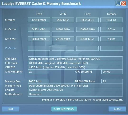

oh its good...it is basically the same as P03R2 from what i have checked thus far. clocking appears to be the same as P03R2 for FSB and Memory and performance with P1/P2 enabled at high FSB is nearly identical. i am fully confident everything else will be the same as well. but don't expect any miracles as far as the corruption issues goes guys...just enjoy the performance and clocking :D
i just started stability testing the FSB but this is exactly what was 12 hr OCCT stable on P03R2, i even turned down FSB voltage a notch. this is on P04 thus far...

Enabled P1 and P2 in QX9770 with 450 fsb
EVGA 790i Ultra
QX9770 4 ghz @ 1.42v
2GB shellshock DDR 3 1800 mhz 7 6 6 21 @ 2.0v
2XGeForce 9800GTX SLI
SoundBlaster X-Fi elite pro
3x150gb wd Raptors Raid-0
2x1TB segate Raid
Tagan 950 watt
Watercooling
I was able to post at 450 with P1 enabled P2 Auto;
http://i225.photobucket.com/albums/d...asy_86/450.jpg
Than BIOS resetted after restart :ROTF:
