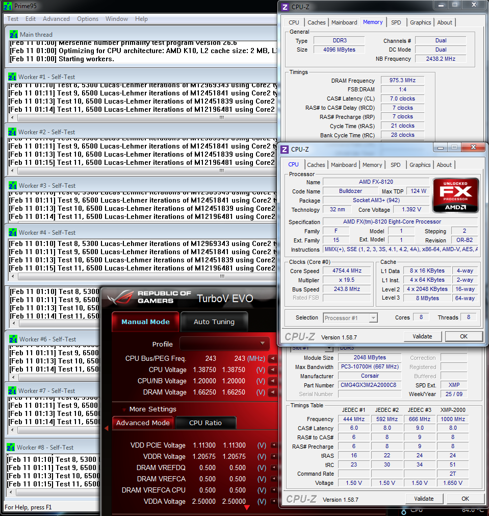

Even though my mem clocking skills are a little weak, the 8Gb kits I've been trying lately have gotten me pretty frustrated, so I've been pulling out some old stuff...
The last few days I've been playing with the Corsair GT 2000/CL8 kit. It did pretty well on Deneb, but I had trouble with it on Thuban and the FX.
Anyway tonight I gave up on it's 2000 8-8-8 rating (and the 1866 divider) and tried tightening timings @ 1600. :p:
The results were actually half way decent. Either the board/mem or chip seems to like the 1600 setting much better!
It's only a 15 minute Blend stable shot (Custom/3Gb usage), but I didn't go easy on it (surfing the web and listening to tunes while running) and it seems pretty darn good. :up:
1950 7-7-7
http://i30.photobucket.com/albums/c3...s_1950_CL7.png
Thanks for the advice Zeus (and Beep)... :yepp:
Finally got the Hypers stable on the 8120 with decent clocks & sweet timings!
I can live with this for awhile... :D

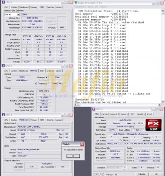

Great 8GB kit for Bulldozer on the CH V Formula:
http://www.overclock.net/image/id/19...600/height/338
2,250 Mhz CL9 1T, with 1.65V
2,333 Mhz CL10 1T, with 1.675V
More here:
http://www.erodov.com/forums/review-...8gb/50354.html
Working on a 16GB kit now and its looking good as well.
Mav2000, those pics are way too small to see (at least for my screen anyway). What are the rest of the timings?
Funny, they dont seem to expand on clicking.
The timings are : First one 2,250 Mhz CL 9-11-10-28-45 1T
Second one: 2,333 CL 10-12-10-28-45 1T
Have not played with any of the timings except first 3.

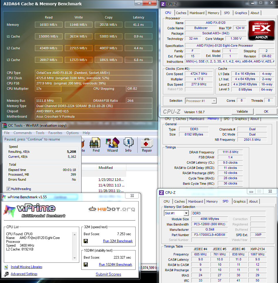

#1
G.Skill RipJawX (Hynix BFR?) 2133 9-11-10 8Gb (2x4) @ 2222 9-11-10 1.6875v
This will be the kit I stick with for now and runs very solid at these clocks without quirks!
It also gives me good balance and the best core clocks (plus is 8Gb :D):

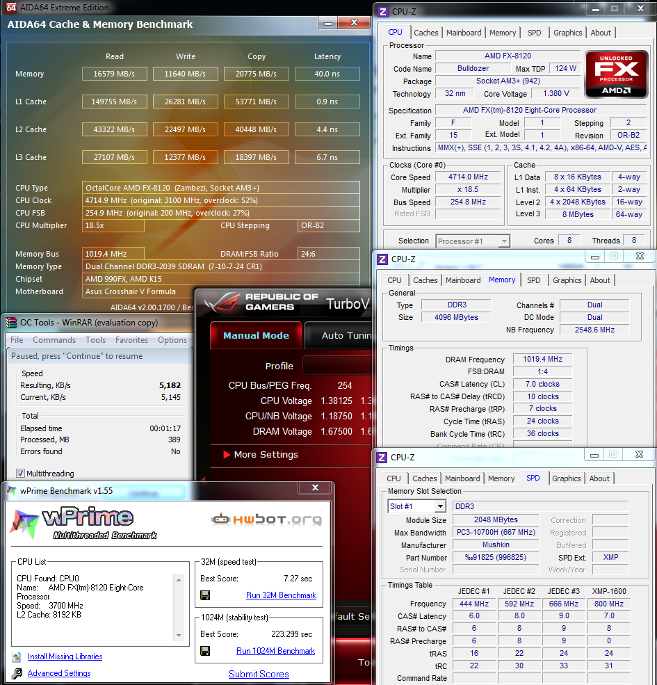

Mushkin Black (PSC ?) 1600 7-8-7 4Gb (2x2) @ 2038 7-10-7 1.675v
This kit has been a staple for me and is still one of my favorite kits... Honestly, it only loses to the RipJaws because it's only 4Gb. ;)
http://i30.photobucket.com/albums/c3...2_Mushkins.png

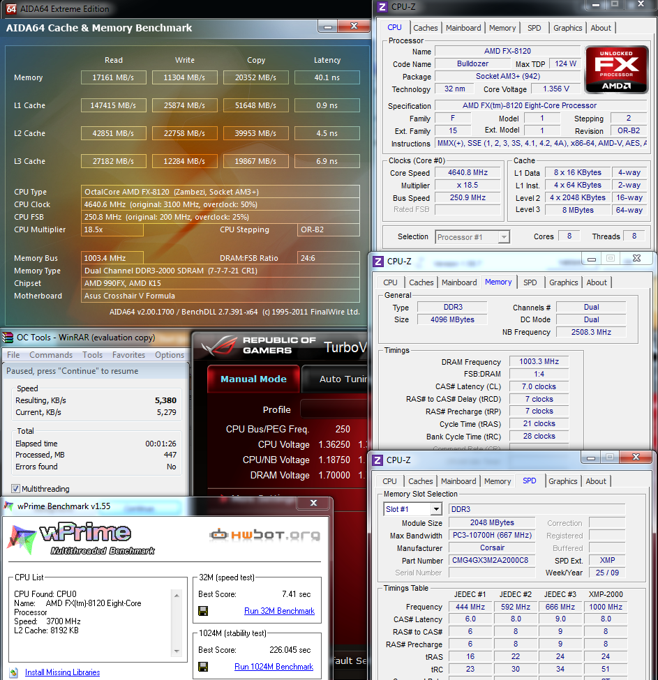

Corsair GT (Hyper) 2000 8-8-8 4GB (2x2) @ 2000 7-7-7 1.70v
This kit offers up some really good numbers (especially in WinRar), but even though it will Blend at these clocks it still has some quirkiness to it.
Sometimes it hangs on post and crashes when encoding video... :rolleyes:
This was a great kit on Deneb, but honestly, I feel I've given it enough chances on Thuban and Zambezi and its just too unreliable IMHO...
http://i30.photobucket.com/albums/c3..._GT_Hypers.png
One thing I've noticed while pushing memory is a serious drop in L2 read speed when you go too far...
Does anyone know if this is just a quirk with AIDA64, or is it a legitimate problem with FX chips?
I haven't really tested this, but it seems like it may be legit and somethng is trashing L2 performance. :shrug:
