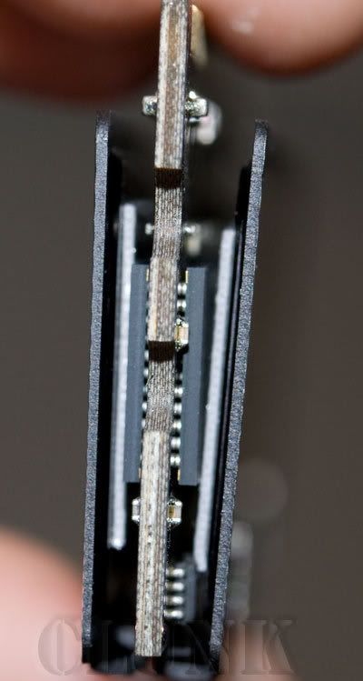

How I fixed: I placed 5 1in binder on them then let a overnight Memtest #5 on tight timmings and high speed.
Now with the tape re-glued by the heat I only need 2 binders on each module and it will fit the 4 sticks without touching each other.
All with active cooling (OCZ XTC).
:up: Fixed:
