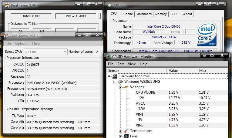

One more thing, RealTemp's VID is 1.2000V while CoreTemp's 1.1125V. Which report is more accurate?

My personal opinion is that the VID that CoreTemp reports is a meaningless number because it can change depending on what motherboard you are using. The VID that RealTemp is reporting might be just as meaningless. I don't know if either program is telling you anything that is hard coded into the chip itself. Intel does not seem to publicly document this information probably because they don't want people hunting through a bunch of chips and trying to find a good one based on VID and returning the rest. I'll tweak the formula used based on the data posted but I won't be too upset if things don't line up exactly with CoreTemp. I've already learned that "just like CoreTemp" is not always a good thing. :D

Edit: Here's my second try at VID that looks just like CoreTemp so everyone will be happy.
http://www.fileden.com/files/2008/3/...alTempBeta.zip
Edit#2: Just checked all the above posts and the new formula seems to work. Now we need someone to install their CPU in two different motherboards and see if the VID stays the same or changes between different boards.
