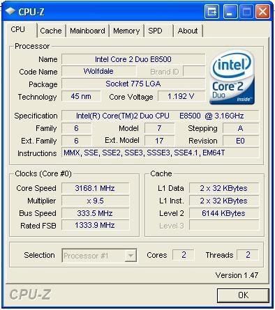

Well I made a jump today and bought an E8500 with E0 stepping
here is an SS of my cpu-z
http://i215.photobucket.com/albums/c...18/comp/ss.jpg
For the cooler i am using a ZALMAN CNPS9700 LED
I would like to overclock this PC, however i'm very new to overclocking. Anybody have some info i can read to educate myself? (basically what to tinker with, and how to test if its stable)
thanks!

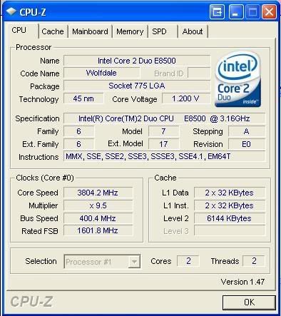

Mike, I see you bought a new CPU :). E8500 with E0 stepping is very good for overclocking so you should be able to overclock it to 3,9-4GHz at stock voltage. You should start with those settings:
CPU Frequency: 400MHz
DRAM Frequency: 800MHz
Performance Mode: Auto
PCI Express Frequency: 100MHz
PCI Clock Synchronization Mode: 33.33MHz
Memory Voltage: 2V
CPU VCore Voltage: Auto
FSB Termination Voltage: 1.3V
MCH Chipset Voltage: 1.65V
ICH Chipset Voltage: 1.05V
This will give you 3,8GHz and those settings should be stable with stock voltage. Don't forget to enable SPD Timings in BIOS, because your system won't be stable without that. You can use ORTHOS to test your system's stability. If those settigns will be stable, then you can try overclocking a bit more.

I set those settings in the bios and now here is what my CPU-Z looks like
http://i215.photobucket.com/albums/c...mp/9-28-08.jpg
Looking at my voltage is everything OK?

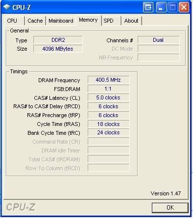

Also I did set SPD to ENABLED it looks like this:
http://i215.photobucket.com/albums/c...-28-08-mem.jpg
I do have 4-4-4-12 ddr800 dual channel, why would SPD slow it down?

Mike, if you set SPD timings, then you always get 5-6-6-18 timings. But you have to do that, because our motherboards have some troubles with custom timings and FSB speeds exceeding 370MHz. For controlling fans speed I'm using Asus PC Probe II.
