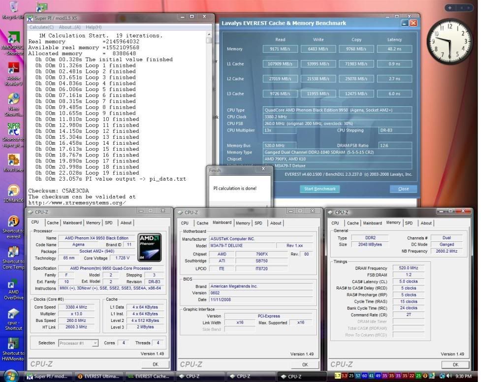

Update,, Using Vista32bit ,, it can run 5200HT total:D I tried with XP and didnt think i could get the same results. I havnt tried for High Clocks with HIGH HT since. I just wanted to see how much HT would go with High NB on this OS. Not too shabby .
3380mhz with 2600NB and 2600HT Ram1040mhz
http://i168.photobucket.com/albums/u..._5200total.jpg

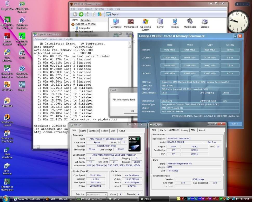

3500mhz with 2600NB and 2600HT Ram1040mhz
http://i168.photobucket.com/albums/u...00_3500mhz.jpg

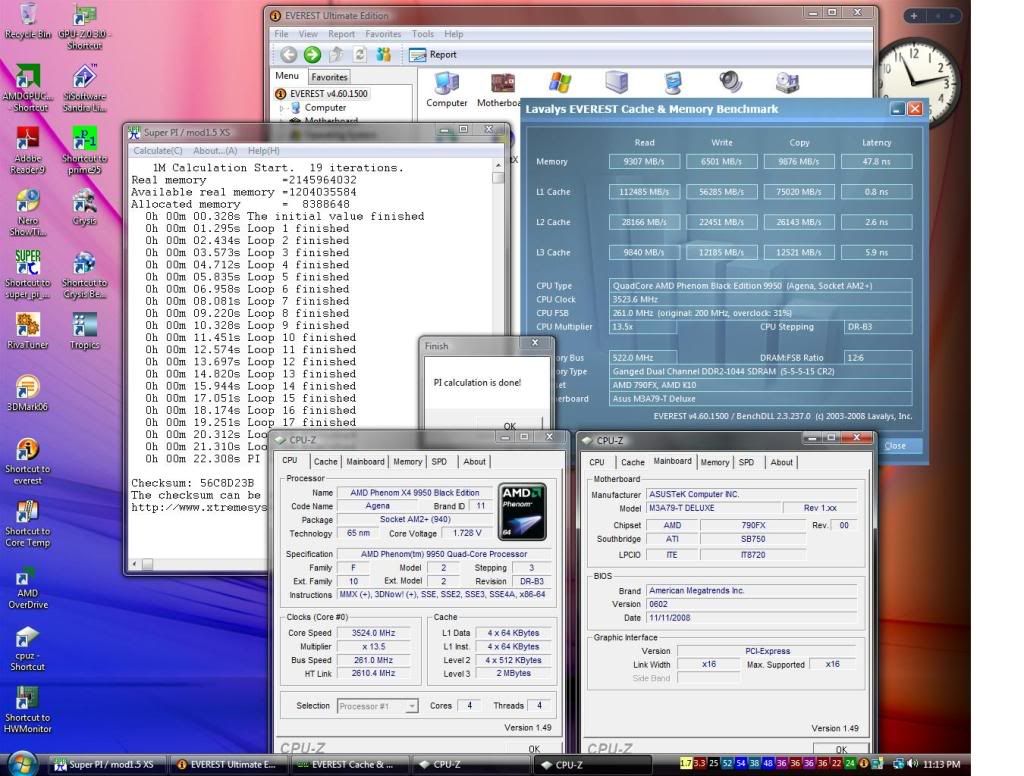

3523mhz with 2610NB and 2610HT RAM 1044mhz
Highest stable Clocks with Vista32bit.
This is my max best for everything HIGH:yepp:
http://i168.photobucket.com/albums/u...10_3523mhz.jpg

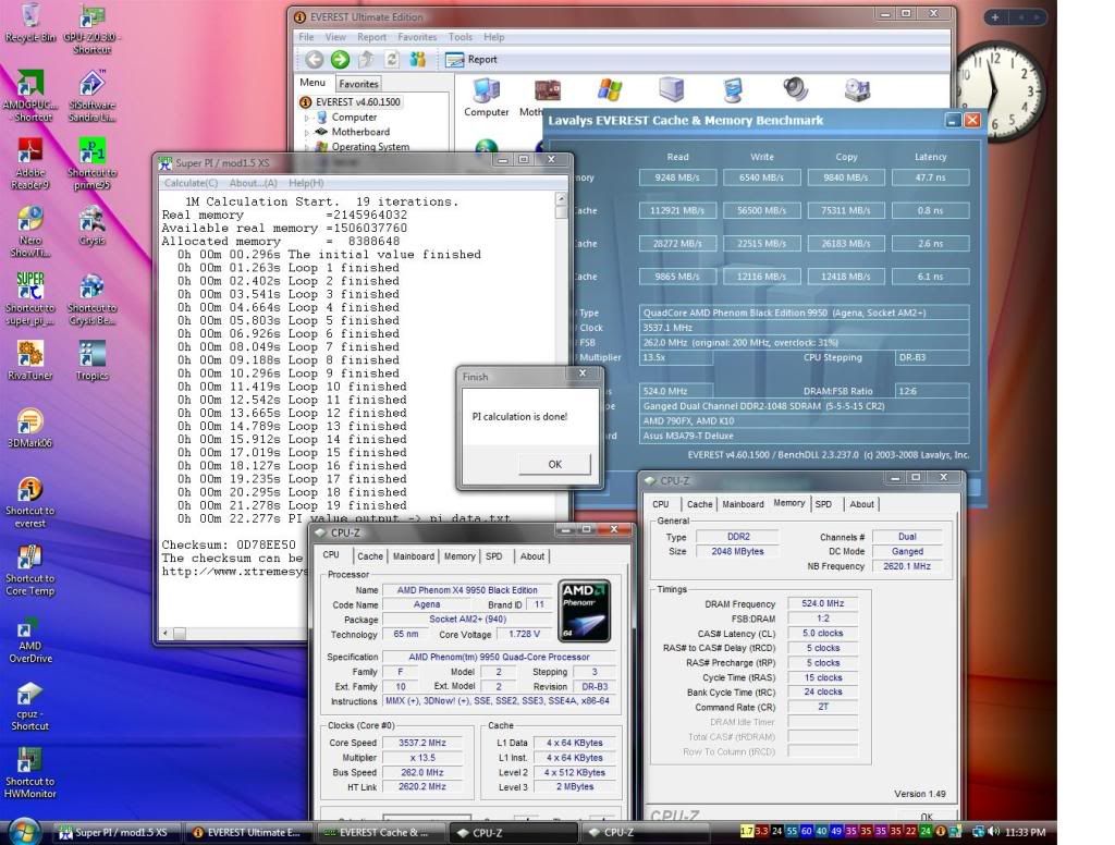

OMG i tried this just for KICKS 3537mhz 2620NB 2620HT
This set up scares me lol. Ok no more i quit! This made me Beer foam,, Ive never ran 2600+NB and HT over 3.5ghz Never, Need More beer and that was with XP. Vista 32bit just shocked me real good !
http://i168.photobucket.com/albums/u...0NB_2620HT.jpg
