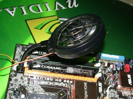

When i had all the extra room due to water cooling, i used a couple of Antec Spot cools for the hot areas. They worked wonders. They do great on the memory as well. No luck with these big arse air CPU coolers in the way though.
http://www.sinaimg.cn/IT/h/2007-10-1...15d4aedf65.jpg
http://www.xsreviews.co.uk/modules/F...Cool/Stock.jpg
