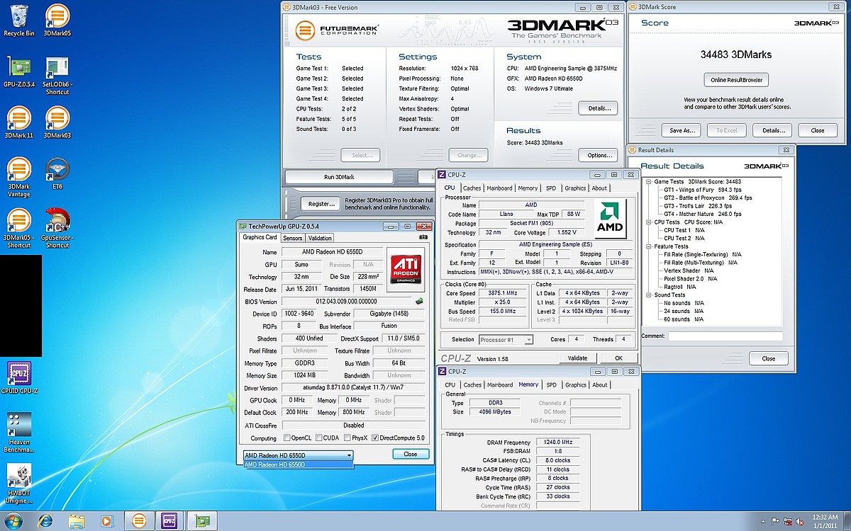

03, ran it once to get a baseline of where I was at score wise.
http://chew.ln2cooling.com/qdig-file...203d03%201.jpg

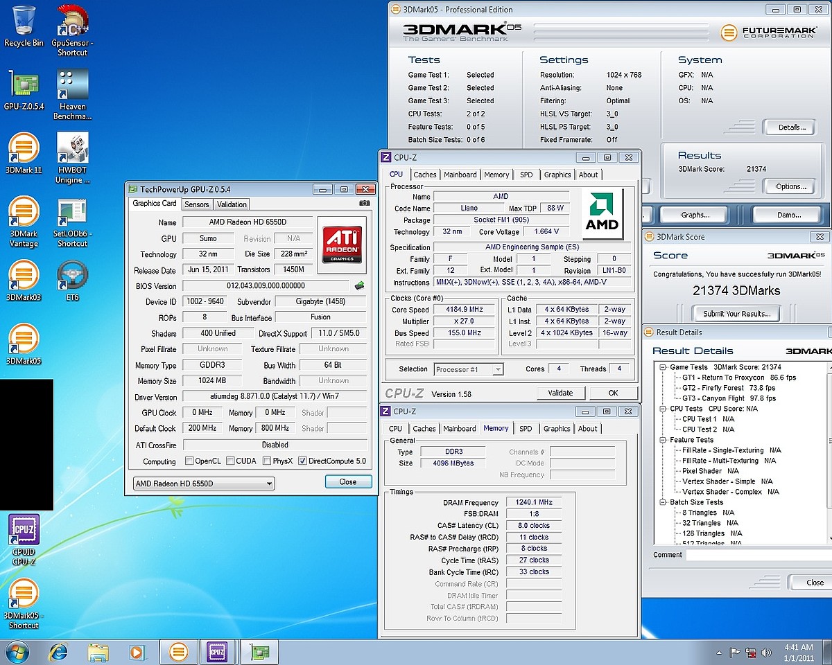

05 minimal improvement, GT1 is lacking here compared to my other run, sacrificing ram timings + cpu clocks in this bench has it's drawbacks.
http://chew.ln2cooling.com/qdig-file...203d05%203.jpg

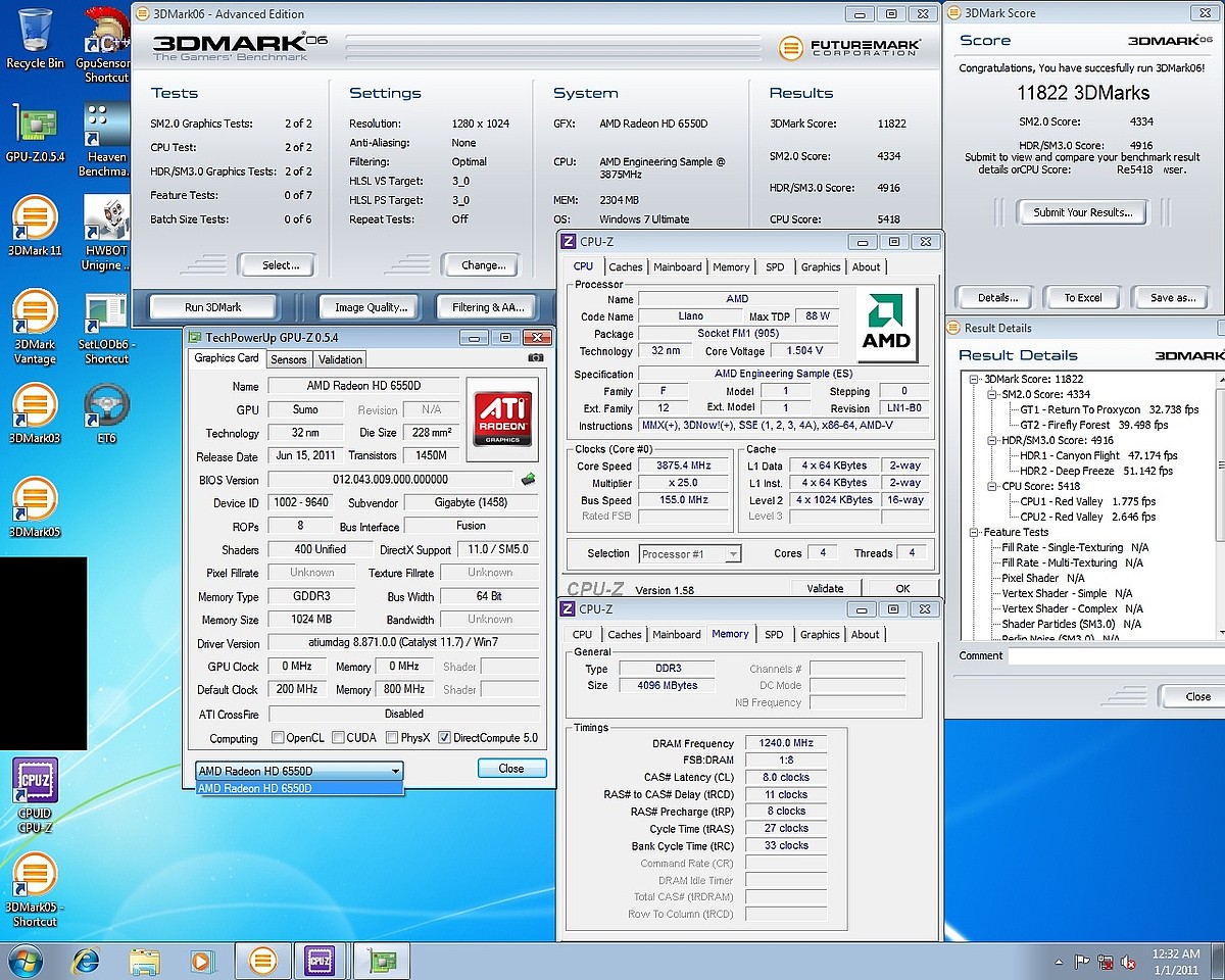

06, the gains are ok I guess, Ram timings don't seem to have to big an impact in this bench. CPU being dropped probably cost a little compared to previous run.
http://chew.ln2cooling.com/qdig-file...203d06%203.jpg

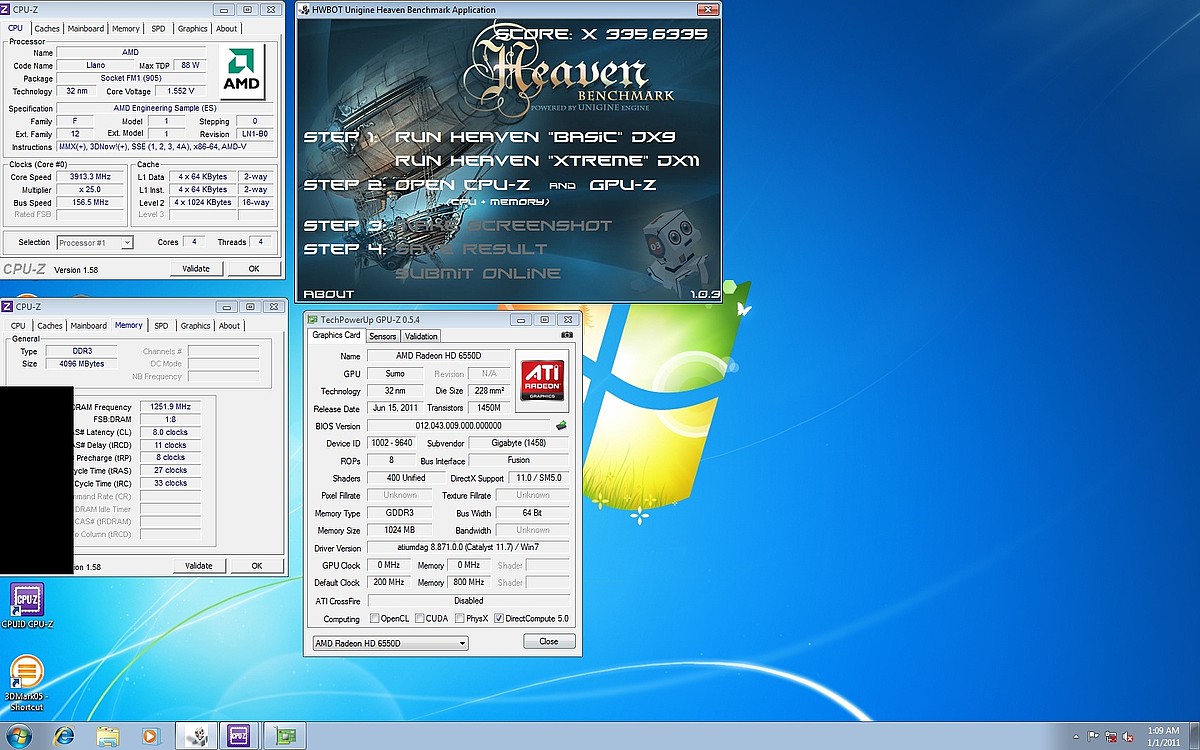

Heaven, heaven is just brutal, so much power needed for so little gains.
http://chew.ln2cooling.com/qdig-file...heaven%202.jpg

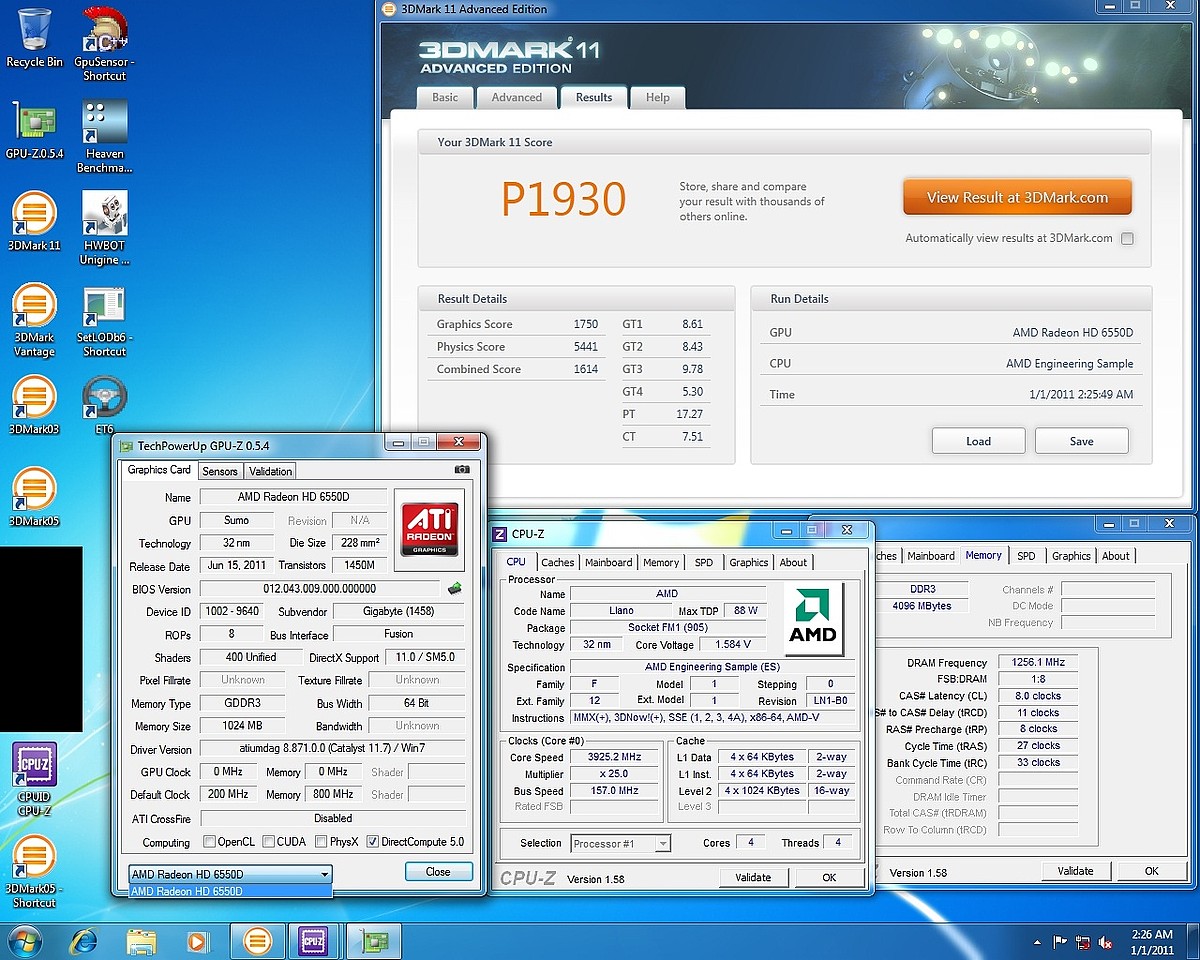

3D 11 is scaling decent.
http://chew.ln2cooling.com/qdig-file...d11%201930.jpg

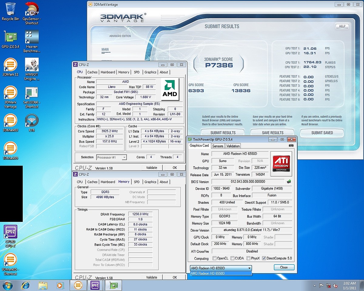

Vantage, I just really found a sweet spot here, finally cracked 21 FPS in GT1 and 16 FPS in GT 2.
http://chew.ln2cooling.com/qdig-file...%20vantage.jpg

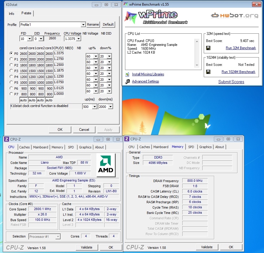

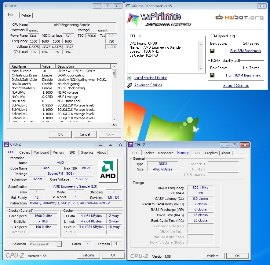

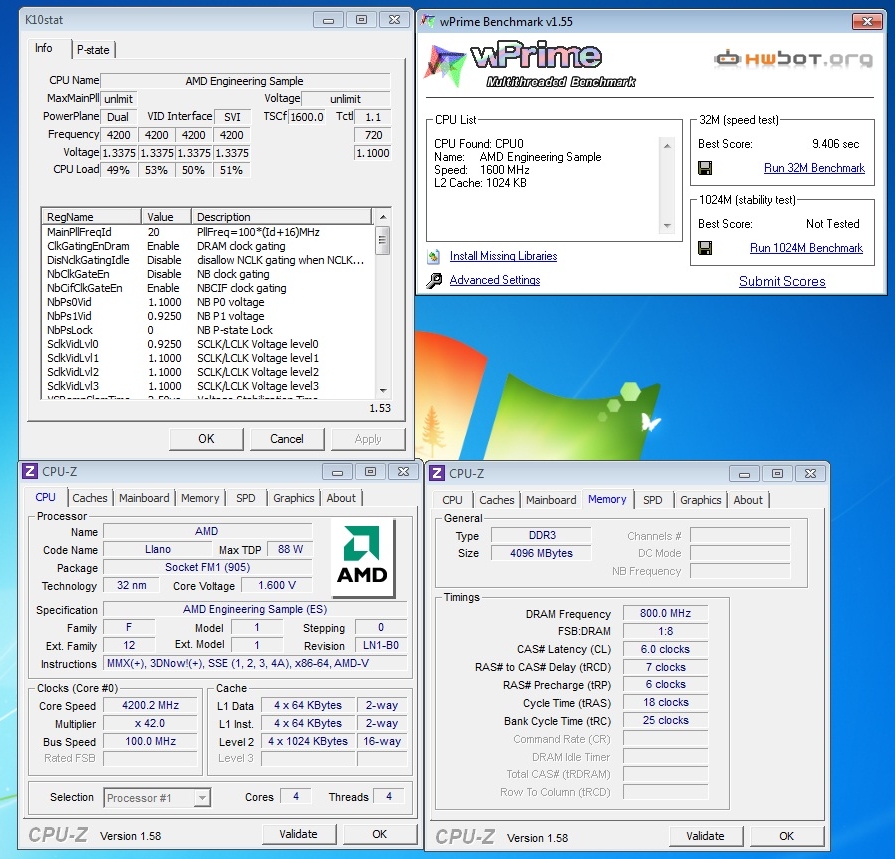

I used Wprime to first measure performance at a given clock and also show the speeds are "REAL" not bugged.
First a Base line run at lowest multi 16x Mode 0

Second Base line run at 42X Mode 0

Mode 1 = cpuz reported + 1600mhz As we see the time is cut in half compared to the above 1600mhz run.
http://chew.ln2cooling.com/Llano/pll...201%201600.jpg
Mode 1 = cpuz reported + 1600 mhz As we can see the time is identical to the above run at 4200mhz.
http://chew.ln2cooling.com/Llano/pll...201%204200.jpg
