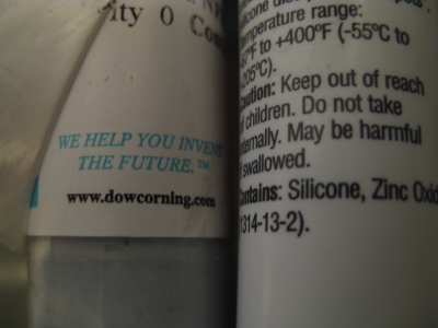

6. Mix up your own thermal suspension (do some research and you'll find stuff better than ceramic, or silver).
