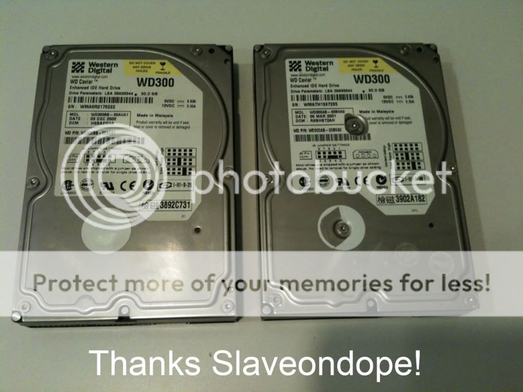

Thanks to Slaveondope for providing 2 hard drives :up:

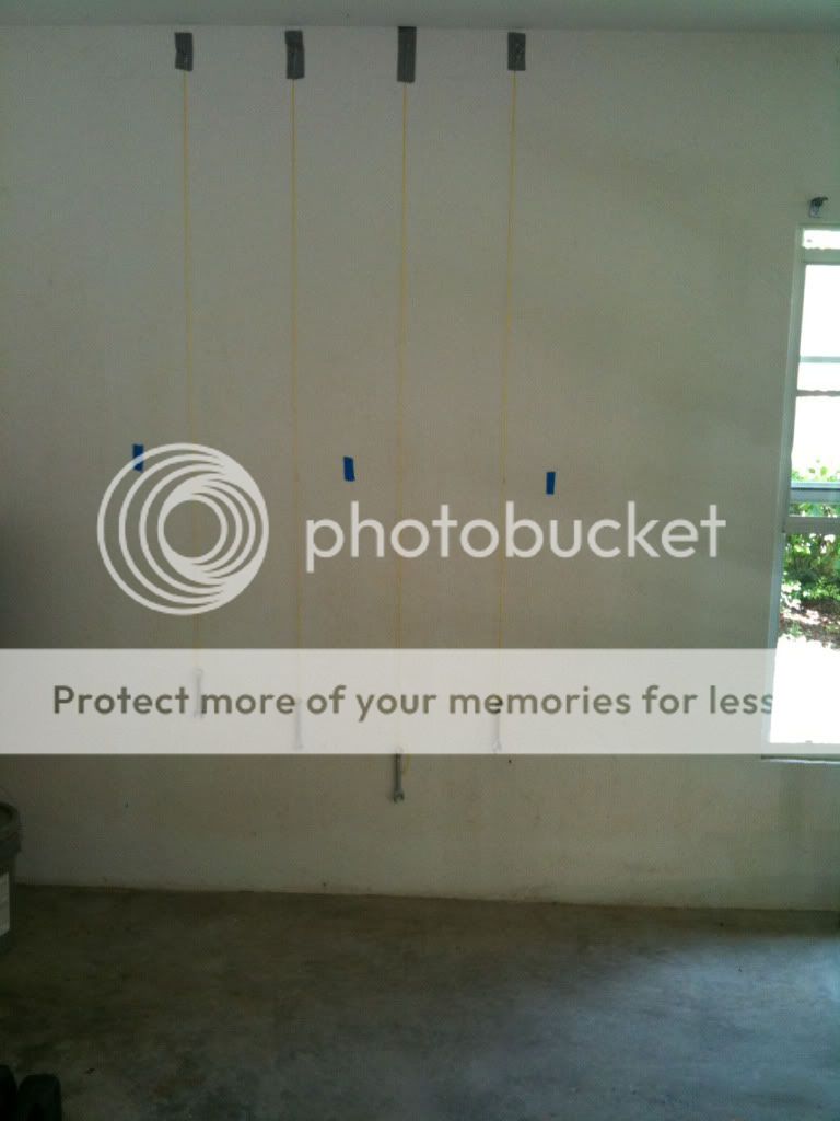

Starting; the plumb lines will be the conduit lines. I am running 4 120v 20amp lines to quadplex outlets. The blue tape represents my ceiling joist:
http://i399.photobucket.com/albums/p...t/Starting.jpg

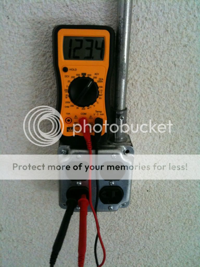

I'll skip all the grimy work and just get to the good stuff :) Heres my first outlet up and running, thanks to a good walk through from Hicks everything went really smooth; I didn't have to redo anything or stop working to go buy more electrical equipment.
http://i399.photobucket.com/albums/p...line4works.jpg

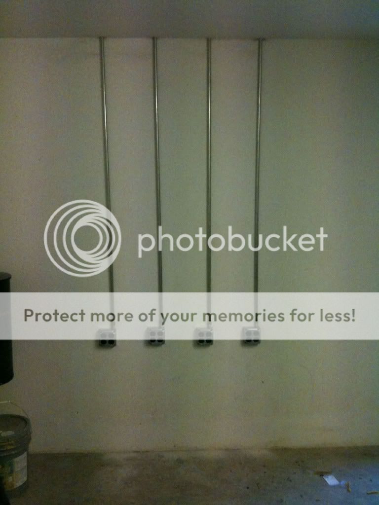

Heres a preview of the final product: Only the 4th line is live right now and I still need to add a few wall straps to the conduit; easy work for tomorrow:
http://i399.photobucket.com/albums/p...t/4sockets.jpg

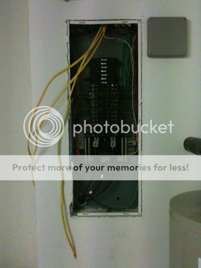

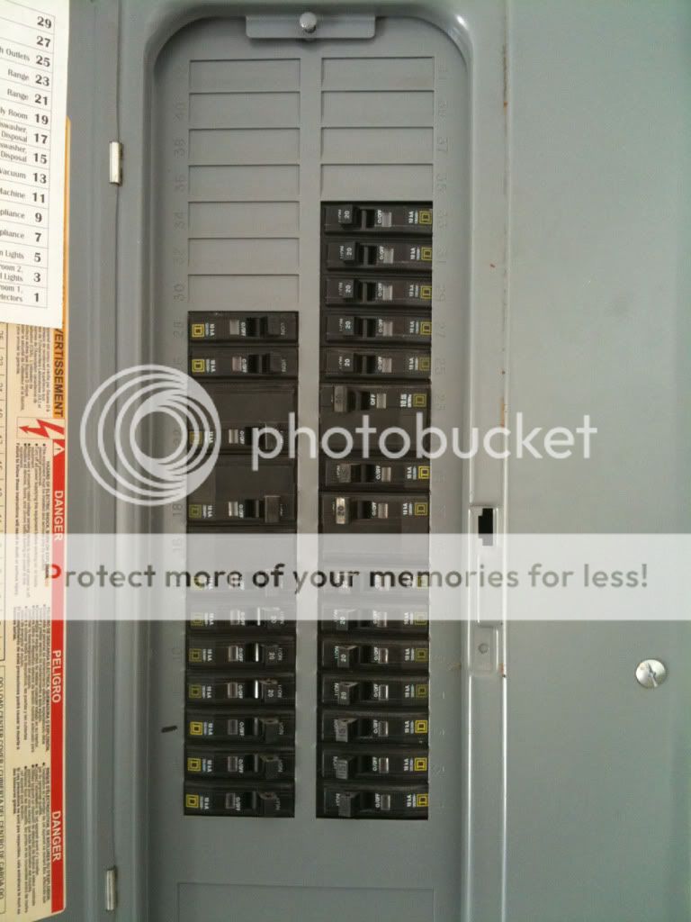

This is how I left my panel for the night. The sun was starting to set so I didn't wire lines 1, 2, and 3 at the panel; I taped them off for the night and labeled them. More easy work for tomorrow.
http://i399.photobucket.com/albums/p...ject/panel.jpg
Well; thats progress for the day. I changed from my original plan of running 240V lines and sticking with 120V. I lose a % or two of PSU efficiency but I can buy off the shelf surge protectors and UPS's with 120V. My power has been very stable here recently but sometimes lightning storms can cause brown outs or short power outages so it would be nice to have the farm all on UPS's eventually to keep running through a brownout or 15 second power outage.

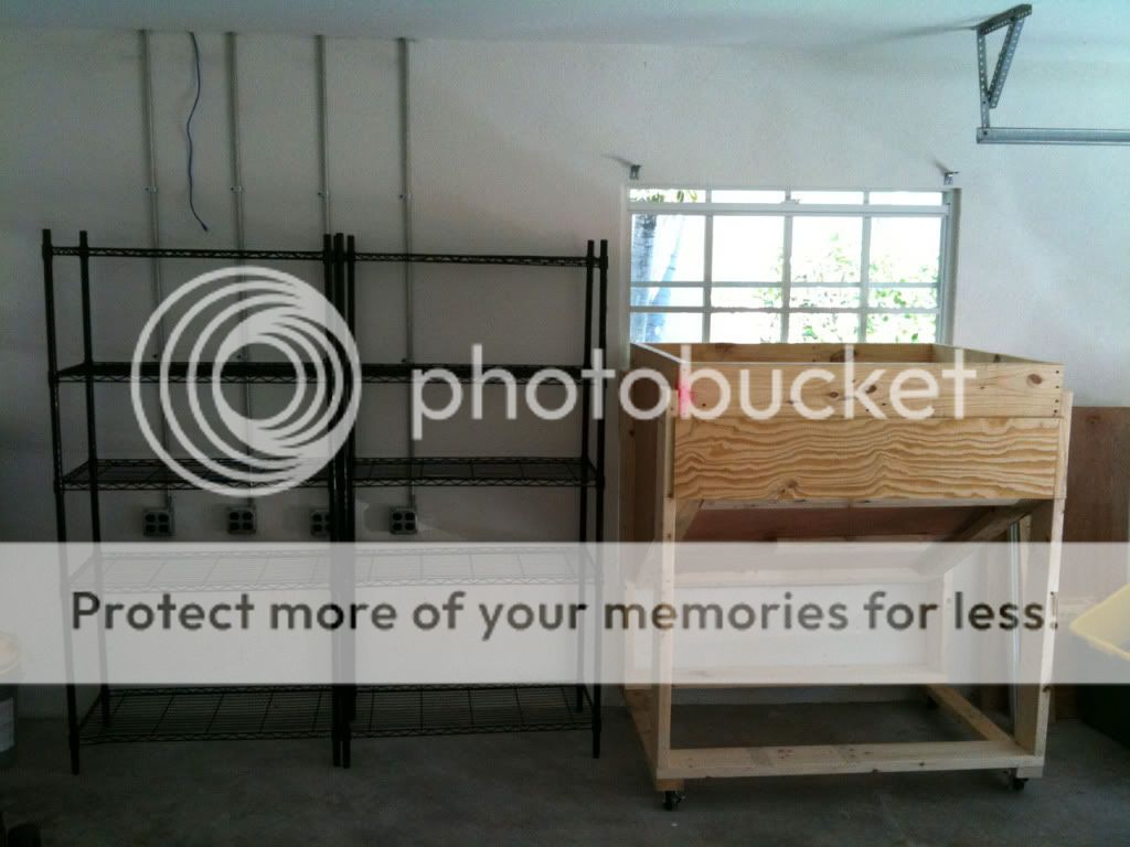

Todays Update:
Finished the wiring in the morning and got the panel back together. All 4 outlets worked right the first time; I didn't have to go back and rework anything thankfully. The top right 4 breakers are the ones I installed; 4 20amp breakers.
http://i399.photobucket.com/albums/p...ishedpanel.jpg

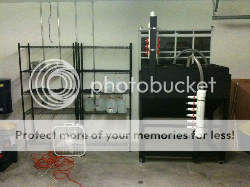

Shelves in place with the rad holder in place at mid-day; I ran an internet cable this morning also which is just dangling above my racks to be plugged into a switch that will go on the top shelf.
http://i399.photobucket.com/albums/p...ct/mid-day.jpg

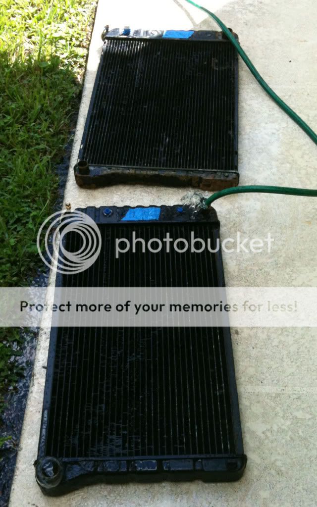

I soaked the rads with a ~50/50 Water Vinegar mixture last night; so this morning I gave them a good final flushing with the garden hose. Unfortunately I could not find a local shop that would soak and flush the rads so I had to do it the hard-way but they are good to go now.
http://i399.photobucket.com/albums/p...finalflush.jpg
