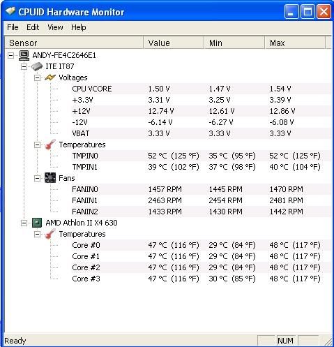

okay come to the end with it, this is the result. Yep really high vcore but who cares, its a cheap chip and can be replaced however im really disappointed on how high i have to run it but i will use CnQ so will help.
http://img.photobucket.com/albums/v228/Lemzip/final.jpg
Man, it just looks like you're rooked. What are your load temps from that last screenie?
lol, whats rooked i have no idea!
running it on a mugan 2 so temps are quite good.
Here is a screenie while prime is running @15 mins. When idle its around 23-30 however i have been virus scanning so its a bit more. Also can you tell me wher ei put it the cpu-nb voltage on this board, also out of interest when will i start seeing some damage to the chip at this vcore?
http://img.photobucket.com/albums/v228/Lemzip/temp.jpg
just thinking
If the max core v is 1.425v, if i do the usual add 10% max to the core i could potentially run it as 1.5675v and i wouldnt see much issues with regarding to damage over a year with CnQ enabled as my cooling is keeping it quite cool at 1.5v without going over 50.
