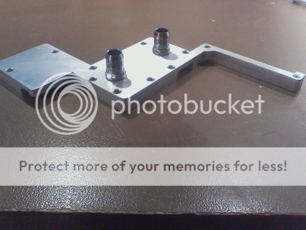

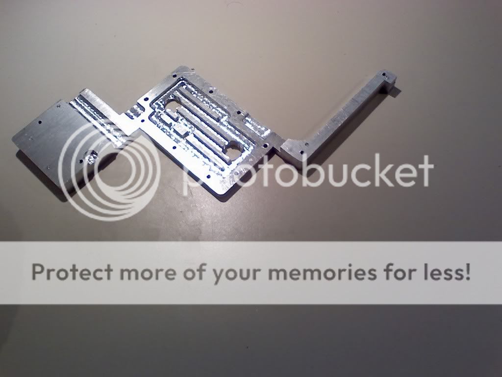

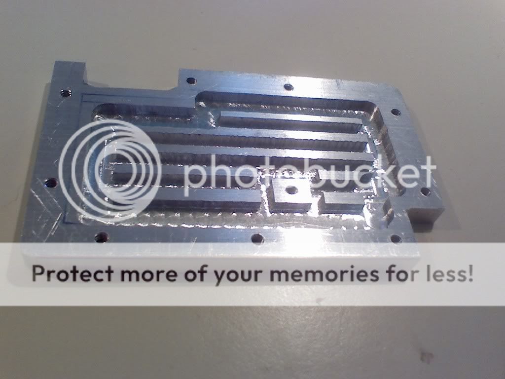

After HOURS of milling, the aluminum block is complete (less sealing, lapping, and finish sanding)
http://i590.photobucket.com/albums/s...0918091703.jpg
http://i590.photobucket.com/albums/s...0918091803.jpg
http://i590.photobucket.com/albums/s...0918091814.jpg
http://i590.photobucket.com/albums/s...0918091813.jpg
looks nice, u should make some more of them the quality looks great and it could lead to some profit. u just need the copper now.

I am not ditching anything. let the buyer beware, I will make whatever someone wants. If someone wants aluminum, and they choose to use non-corrosive techniques to treat their water loop, then they shouldn't have any problems. I am sure 99% of people will choose the copper, (as would I) but alum was easier to make, and its cheaper. Plus I need a reference block for myself to make future blocks so the alu fits the bill.
Remember, this block was me testing how long it would take to make the block from scratch, (plus give you guys some eye candy to look at in the mean time while I work on the copper version).
Looks really sweet, nice job.

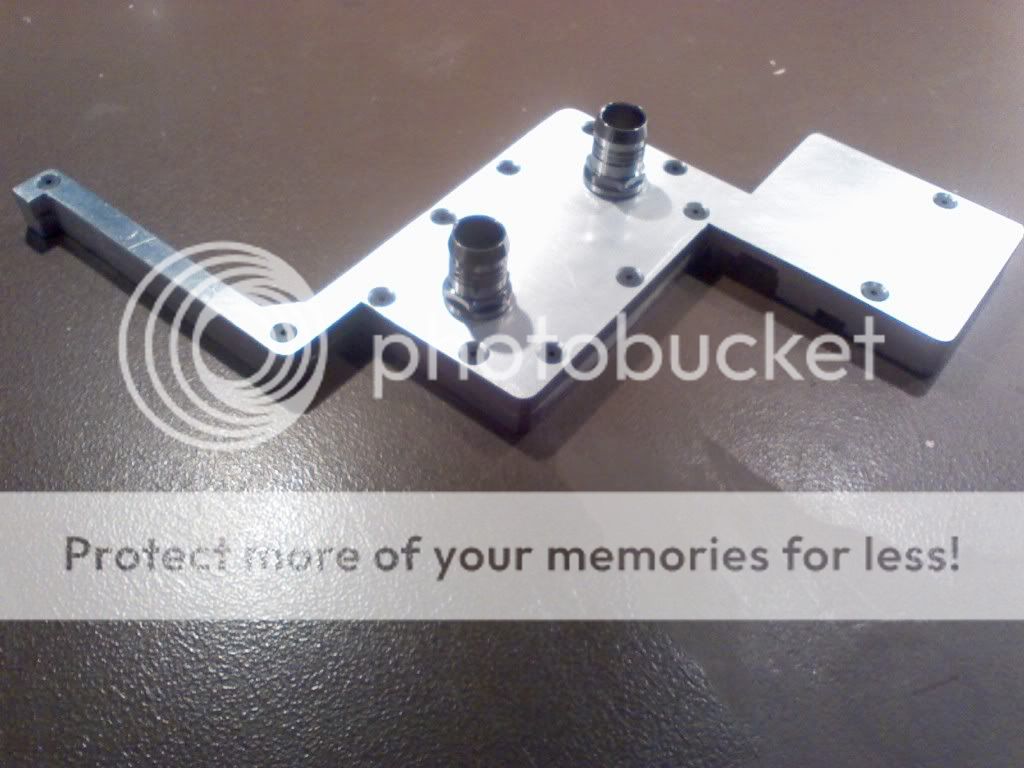

With the new black, bitspower fittings

Can you do some flow tests on it as well?
Question, does it leak? i dont see anything that is sealingthe 2 parts other than screws....
Don't think I am going to seal this block. it is a test block to test fabrication methods. Also for alignment of screw holes. If I seal it... it will be "difficult" to take apart.

I don't have any equipment to measure any flow. I connect the pump, and what goes it, comes out, as long as its fast, there is zero restriction. The internal volume of the block is larger then the volume of a 1/2" pipe, and as you can see, the water travels straight. I don't see any problems.
if you seal it all you need to do is mill out a space for a rubber gasket that will fit around the thing.
This.
Yeah like what has been said above me, a sealing gasket is all that is needed, no glues/sealants. but fo this you would need to mill it out in your engineering samples to make sure you dont get leakage or weakening from tightening etc, and then leakage onto parts.
its looking good though btw.
thanks. Not quite sure what u mean. Permatex will work. I won't do this alu block simply for the sake of I don't wanna take it apart a dozen times to make other copies of it. The blocks have tremendous value for hole templates alone, and the measurements. I already marked out a copper block for the real deal. I will keep you guys in the loop. no worries ;) i always appreciate suggestions.
He's refering to this:
http://www.performance-pcs.com/catal...-Nickel_01.jpg
You can see the o-ring. People do like to take their blocks apart to clean them, and some may like to see an option to add in an acrylic top. It is easier to do all this with an oring vs having to use permatex.
Absolutely. I agree, much easier to take the block apart with an o-ring. However, cutting a channel for an 0-ring adds more meat on the outside, and takes away from the internal cavity where the water sits, making the block less effective.
Also it would be a point of failure on the block. Not a whole lot of room to work with, and Permatex works just fine. At least you still have the ability to take the block apart if I use Permatex, rather then braze them together. Think of it as changing your thermostat in your car, just outside the car and it wont be so bad. ;)
