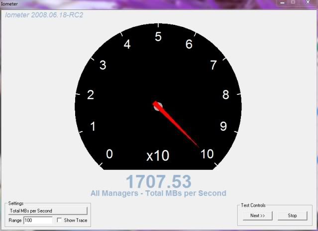

Computard (OCZ & [H] forums) is definitely getting to grips with his new 9260-8i card now:
Anyone for 1.7gb/s+ throughput? :D
8x Vertex 30GB running on Classified 759 (with an overclocked PCI-e bus):
http://i263.photobucket.com/albums/i...m/fast-lol.jpg
Just PM'd him to see if he managed to beat down on the read latency any... will report back when I get a response....
