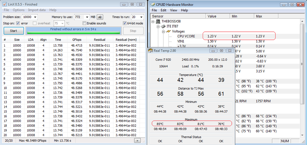

Currently testing 3838A671 i7 920 (ver. 002 on label) presently at 3.8GHz 1.23v load (1.2625v BIOS), GA-EX58-UD4P F6a on TRUE120 push-pull, EIST/C-states feature is on. Should be good enough setting for 24/7 ops.
http://i173.photobucket.com/albums/w...X58GA-UD4P.png
