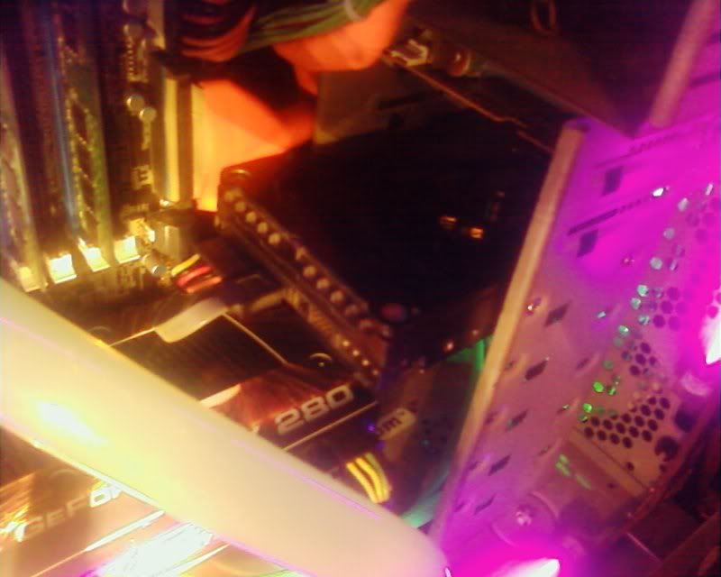

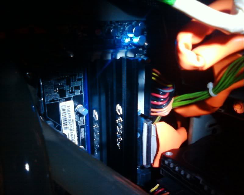

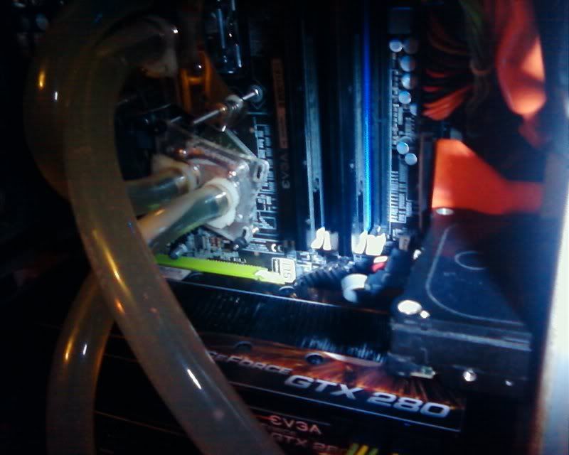

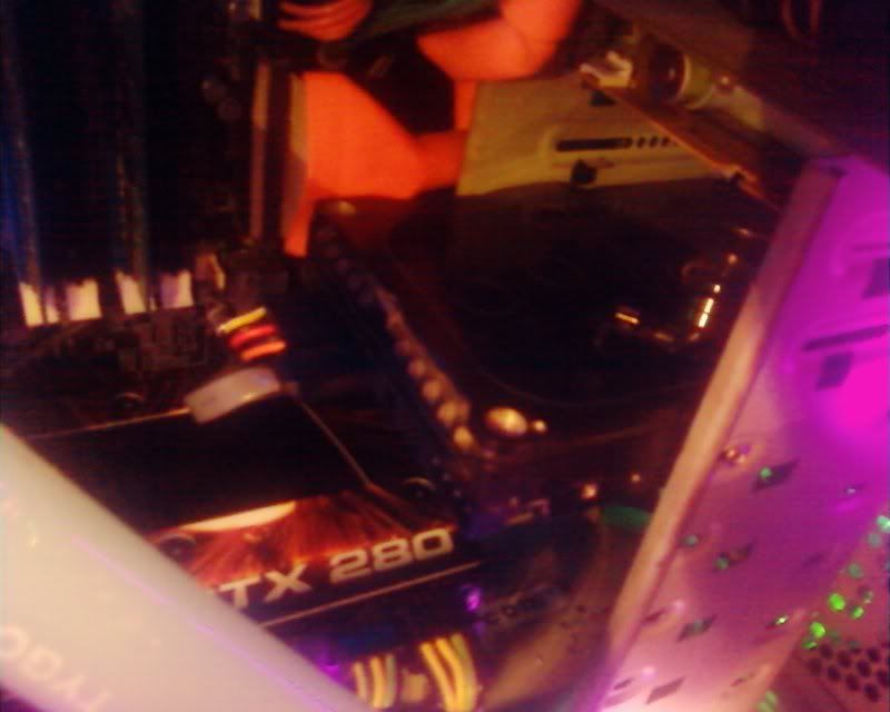

the only draw back that i see at the moment is for the monster 9800 GTX cards which overlaps the backside of the board...my 9800 goes right over the middle of the Sata Ports so you would need to hook the Sata cables in first before inserting the VC...be aware that the ports are configured at 90 degress so the plug-in openings will be facing to the rear of the case....i am sure other people will find other little nagging annoyances about placement of certain ports, but not evey board is perfect unless you pay $400 for it!;)
