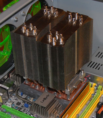

The TRUEs are mounted like this with the motherboard perpendicular to the ground.
http://lh6.google.com/kgeronilla/R_s.../TRUETEC10.jpg

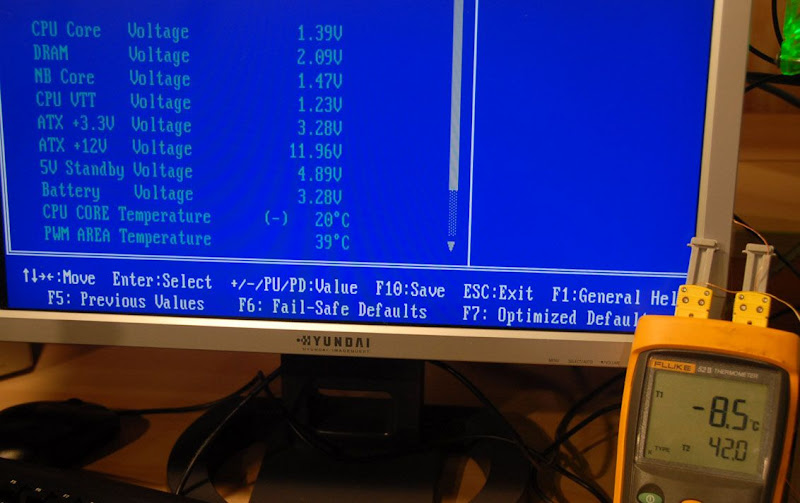

Both probes read 23.5C before I turned the PC on.
Both TEC power supplies are set to 9.2V.
http://lh4.ggpht.com/kgeronilla/R_2h.../TRUETEC13.jpg
The core temperature in the bios is obviously wrong, but at least I know it is getting cold.
Temperature cold plate = -8.5C
Temperature hot plate = 42.0C
http://lh5.ggpht.com/kgeronilla/R_2i.../TRUETEC12.jpg

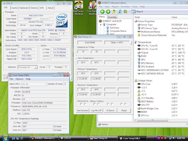

In vista, both core temperatures are stuck. This is the stable overclock I had with just air cooling.
http://lh6.ggpht.com/kgeronilla/R_2i.../TRUETEC14.jpg

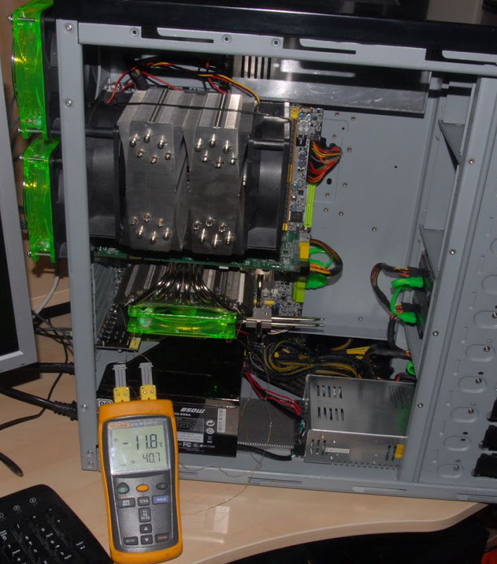

Here is an idle shot. You can see where I put the 2 TEC power supplies.
Temperature cold plate = -11.8C
Temperature hot plate = 40.7C
http://lh6.ggpht.com/kgeronilla/R_2i.../TRUETEC15.jpg

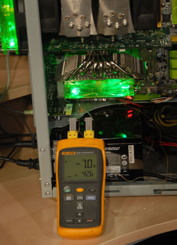

Here is a full load shot. I ran superpi 32M. This is a 11.5 minute test. These are the highest temperature that I saw during the test. The temps rose to this level after a minutes or so into the test and stayed around there for the remainder of the test.
Temperature cold plate = -7.0C
Temperature hot plate = 42.6C
http://lh4.ggpht.com/kgeronilla/R_2i.../TRUETEC16.jpg

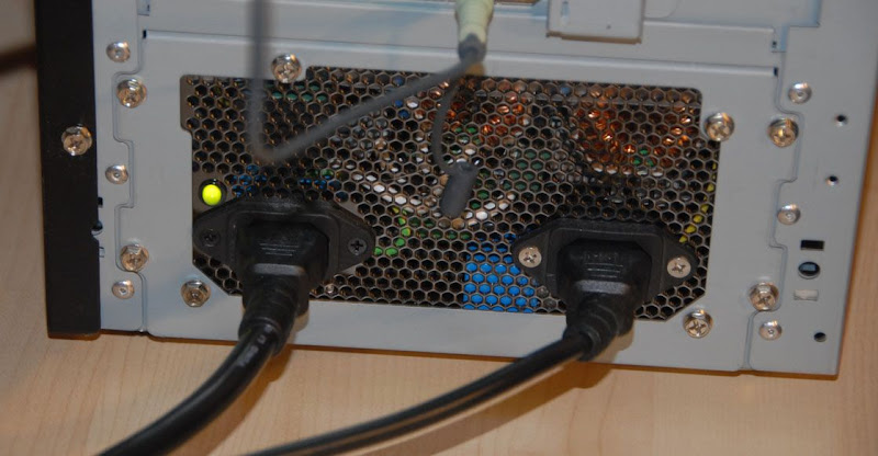

PC power is on the left and TEC power is on the right. You can even see the blue relay that turns the TEC power supplies on with the PC.
