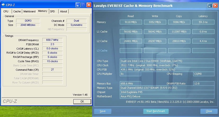

These are my Team 8500's at 2.29v (real - DMM measured)
http://i266.photobucket.com/albums/i...verestcpuz.jpg

Cheers. I set 2.22v in bios, my board overvolts by 0.07v from the bios set value. I always measure vdimm with my dmm though so I know what i'm giving them.
As for your ram, I'd say the FD5's would probably have the best chance, but the 6400 C3 kit may do quite well too, same with the Reapers if they are the D9 based model. Really just depends how good the IC's are on each set though. All D9 GMH & GKX should hit 1300+ CAS 5 under 2.4v, but the GKX *usually* overclocks better than the GMH on CAS 4.
If I were you i'd test them all on a reasonable voltage, like 2.3v max, and use the best kit as your OC'ing kit, and baby the rest as your 24/7 kits. However, sometimes a kit that performs the worst at low voltage may keep scaling all the way to and past 3.0v, whereas the 'better' low voltage clocking kits stop scaling so well after a certain point.
It's just trial and error. Good luck, sounds like you're going to have some fun, be sure to make a thread showing the results :D

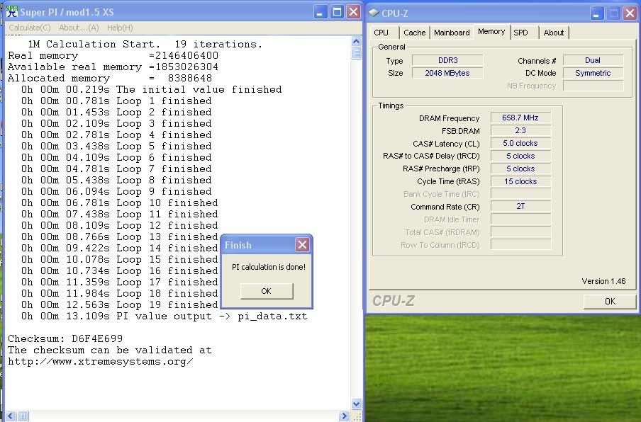

Here's a quick 1M run & everest on mine at DDR 1317 @ 2.29v (real). Everest bandwidth is bad, I was using a low FSB to just test the ram.
http://i266.photobucket.com/albums/i...vrealspi1M.jpg
