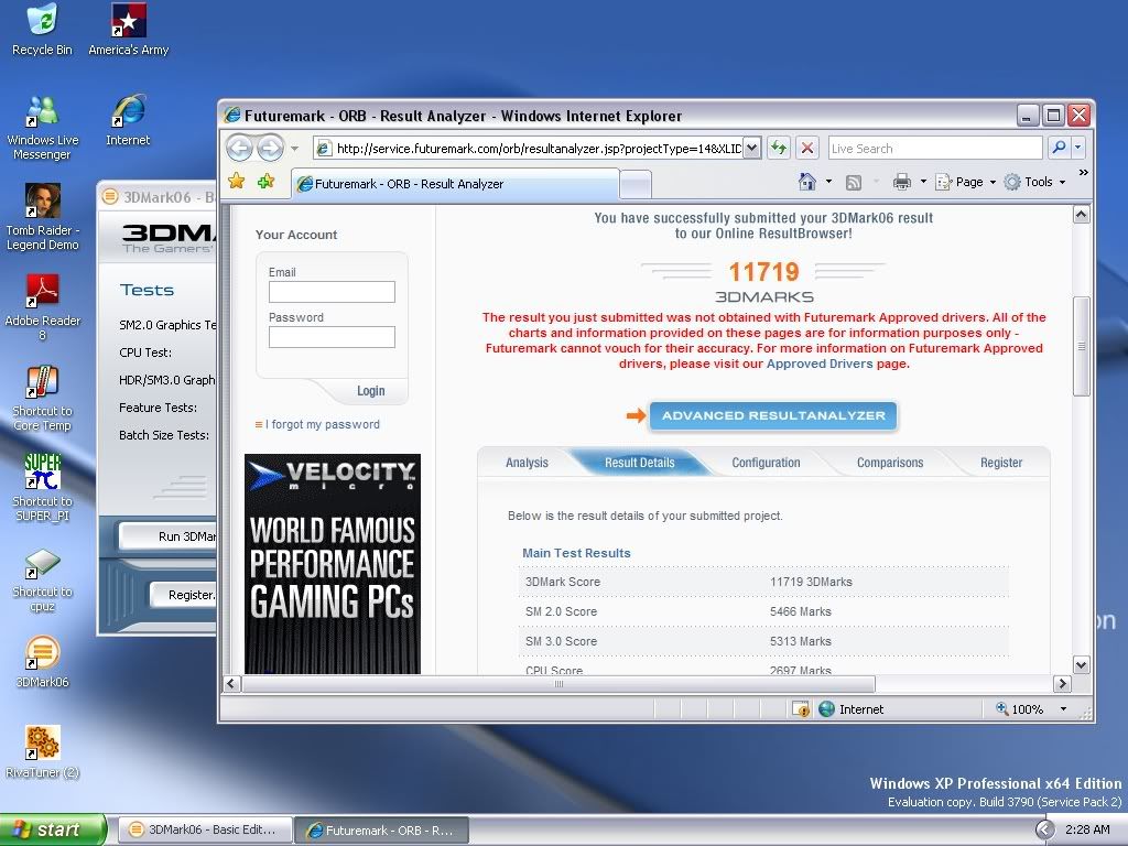

Ok slowly gettin there,working out a few bugs 163.75BetaX64bit
My new 3Dmark06...I lowerd my CPU a lil bit and have been working on just the SM2 and SM3 ...I think im starting to gain a decent Oc now despite the Beta driver and Rivatuner 2.05 ,It seems its harder to Oc with both..I mean i easily clocked whats in my sig with the Older driver,but there is a lot more potential with being able to adjust Shader with out flashing and not using a VMOD....Once i get my card to its full Oc ,Only then will i shoot for 3.6ghz on my Cpu:up:maybe ill really be able to post a decent 3Dmark!!!!!! Remeber i am only working on my SM scores for now ,this way i know my card is doing all the work:yepp:
http://i168.photobucket.com/albums/u...0417822106.jpg

GPU@704mhz//Shader@1782mhz//Memory@2106mhz:up: Idle@42c Load@53c @25cambiant case temp!!!!:up:
http://i168.photobucket.com/albums/u...etinbetter.jpg
