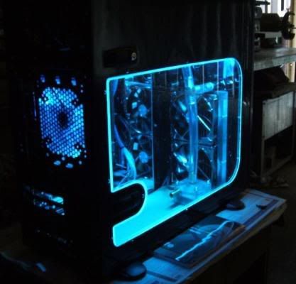

Checkout how the light is transferred in this side window.
Snapper cut a thick piece so it's rebated through the opening.
http://img.photobucket.com/albums/v408/sulk/k097.jpg

Jedda that window is cool, relatively minor change but it looks soo much cooler sticking out like that.
